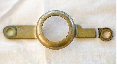

Every fault in the troubleshooting include "valve lift fault". Did you looked at your valve lift solenoid bracket?
