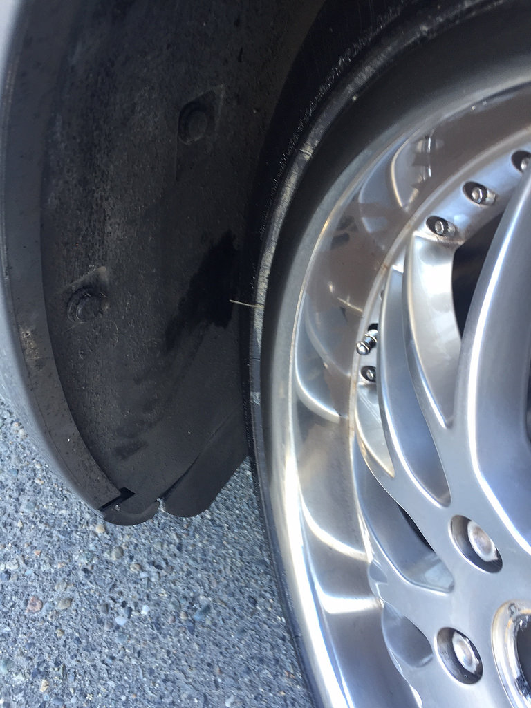

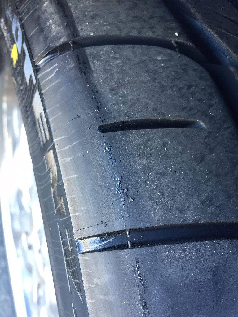

Tips hat to Loren:     Running 245/35/19's in the front, slight rub on outside edge both front and rear:
Swapping for 235/35/19's tomorrow.
I also noticed over a really large whoop going too fast in a parking lot that the rear 305's rub too (can't see any rub marks tho, it was real minor).      Based on my experience I would say the maximum size for 19's on a 996  Narrow Body is 235/35/19 and 295/30/19 on 8.5's front 11's rear.
