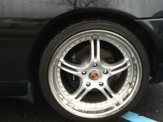

I have 19s. I dont like the ride, but they look good. Anyone know what these are. Looking for a good 18 inch wheel after these tires go bad.
ssr wheels.
These are Elite wheels, not the SSR's. I know because I have these same wheels on my 996. The SSR's have 5 extra small holes offset between the lug holes which these do not. These are now discontinued but were for sale in the past from Vertex via this link (if you are looking for the details on these) http://www.vertexauto.com/showitem.aspx?&id=208702&name=Porsche%20Elite%20Rims%2019%22x11%22%20%26%2019%22x8.5%22%20-%20Silver.

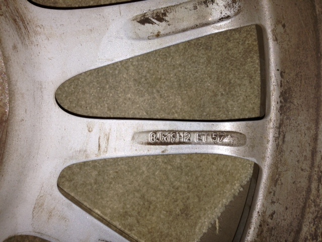

I have purchased 997 rims and trying to fit front, rear are ok but the front hit suspension see photo below.
Any assist would be great originals where 205/18 and trying to fit on 235/19.
post-80010-0-83783900-1362952524_thumb.j
