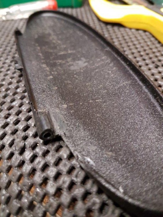

I had exactly the same problem on my 2004 Boxster S, both mirror flaps broken on the hinge.  In the end I plastic welded them using black Lego blocks as filler (ABS plastic).  Then reshaped (note the pointed shape to make them lock open and closed) and redrilled hinge hole.  Worked a treat, both flaps work as new now.
