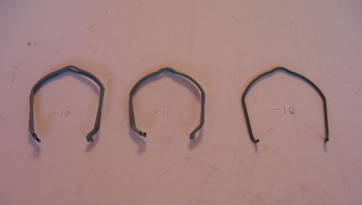

Just for your info. I have found, the hard way, there are 6 different sizes of clips on the TT . The numbers are 996-106-802-10 (-11,-12,-15,-16,-17) depending of the location on the car. Per example the -11 is a little smaller than the -10 ???? But the -12 is a lot bigger....I've made a mistake between two sizes (-10 and -11) and the clip did not hold properly.... Also i've purchase new ones and the clipping action was more firmed....In your case we are talking about -15 and -17, hope they were not misplaced...
post-29683-0-15907600-1338401217_thumb.j
post-29683-0-15173900-1338401229_thumb.j

Those clips look exactly like the turbo hose clips; I have blown them loose in the past. The correction was that you had to be very meticulous in lining up the hoses when you clicked them in.
I still think it is worth investigating whether you have too much pressure in the system.

jpflip, the later on 996 Carrera use also those clips but have a different size, perhaps there is a misunderstanding in this matter.
Thanks for mentioning. It is, in fact, a possibility!
