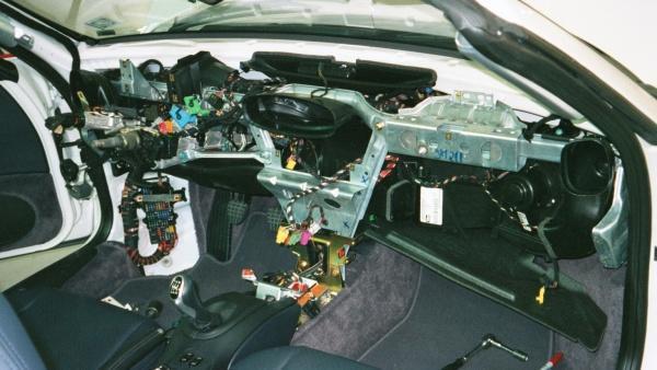

Yes whole dash board. Now I'm familar with removing/installing most of interior pieces & trims, but not sure if I can do the dashboard myself. :help:

That looks very good - but it would be a lot of effort.
If you've got a couple days to do it and some teflon tape and felt tape (anti-squeak) - then go for it.
Its a bit of a mission to r&r the dash. If you do take it on, make sure you stay organized. Toughest part is remembering which bolts go where. When you're coming out with the dash take it slow, if it feels like theres resistance, then double check to see if you forgot any screws. Also when you're going back in with the dash, make sure you have all your wires routed correctly and are not pinching anything between the dash and the body BEFORE you go to screw the thing back in. The wire for the sun sensor is very easy to forget, then when you get just about everything installed you go to install the sun sensor and you've got no wire. I've done it, so trust me on that one. The first dash I did probably took me around 8 hours.

I'm more motivated now with your tips and advices, in addition to Loren's comment. :)
Do you have any instructions or pics? I have workshop manuals, which look good enough for me to get going, but I want to collect any additional information as much as possible.
