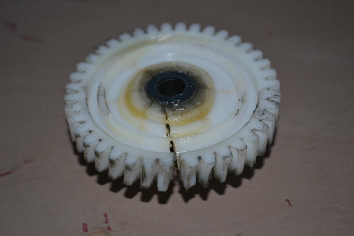

Hi, I have been having trouble with my roof (02, 2.7 Boxster), eventually tracked it down to a split plastic cog ( see photo) in the RHS transmission gearing.
Can anybody help source one of these - anybody got an old transmission laying around they could dismantle and mail the part. I live in Dubai and would send the funds via paypal.

you could try 20th st auto in phoenix, az, usa (porsche, audi and vette specialists)... www.20car.com they may ship internationally.

I managed to get 2 transmissions from E-bay for $100 - I replaced the bad one and all is good.
