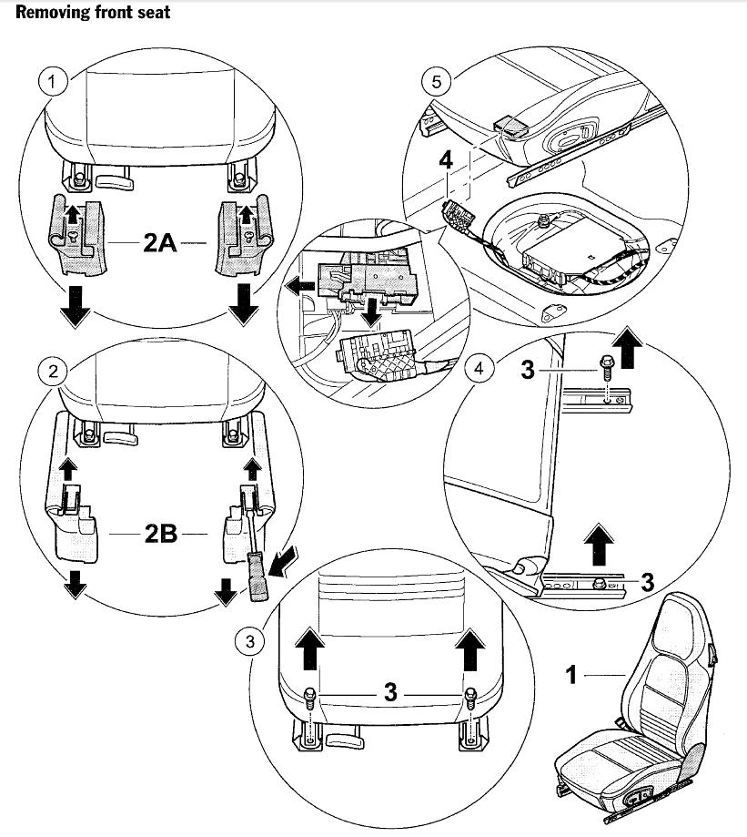

Hi Loren,
Are there any instructions on how to remove the seats? I did a search but couldn't fine anything. I'd also need the torque values when re-installing. I have a 2004 C2 with full power and heated seats.
Simon
1. Disconnect the battery (so you do cause an airbag light).
2. Removing seat rail cover 2A. Unscrew the sheet metal screws out of the seat rail cover at the front 2A. Pull seat rail cover on front end 2A out of the right and left seat rails in forward direction.
3. Removing seat rail cover 2B. Insert a screwdriver under the locking tabs and press lightly upwards.
Caution! Locking tabs can break.
Pull front seat rail cover 2B out of the right and left seat rails towards the front.
4. Move seat to its rear limit position and undo the front M10 x 28 (external) Torx screws 3 from the right and left seat rails using an E12 socket wrench insert.
5. Move seat to its front limit position and undo the M10 x 28 (external) Torx screws 3 from the right and left seat rails using an E12 socket wrench insert.
6. Release plug connector locking device on the side (arrow) and separate the plug connection.
Install is the reverse. Seat bolts torque is 65 Nm (48 ftlb.).
