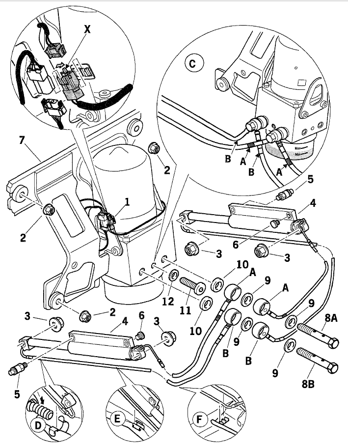

I would like to know if there is a schematic for the hydro lines, pumps etc. in this area Please help
Something like this...
click to enlarge the image
Most of the time are leaking pumps the culprit (# 4 in Loren's diagram) Oil is looking for a way down and drips along the mud flap on the ground.
