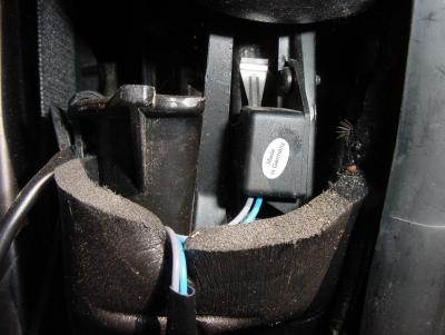

It sounds like a malfunction of your B-Pillar microswitch.
You can trip it manually to see if the "back and forth" cycling goes away.
You can find the switch at the very bottom of the B-Pillar on the driver's side, just below the rim of the half-cylindrical, carpet-covered trim piece behind your left shoulder as you sit in the driver's seat.
Here is a pic:
post-6627-0-00444000-1336622872_thumb.jp
The B-Pillar microswitch gets depressed (i.e., closes) when the top is nearing its fully closed position. As the convertible top frame travels towards the fully closed position, the B-pillar part of the frame presses the switch closed. As the top opens, and the convertible top frame travels back, the switch is open. The closing of the switch tells the double relay that the top is almost closed, then the black lever microswitch gets pressed down by the clamshell and, following what Porsche calls the "after-running time", power to the electric motor is cut off and the idiot light goes out at the same time. On the later Boxsters (i.e., 2000 and later) those two switches were moved to the INSIDE of the transmission on the driver's side.
