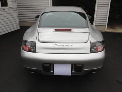

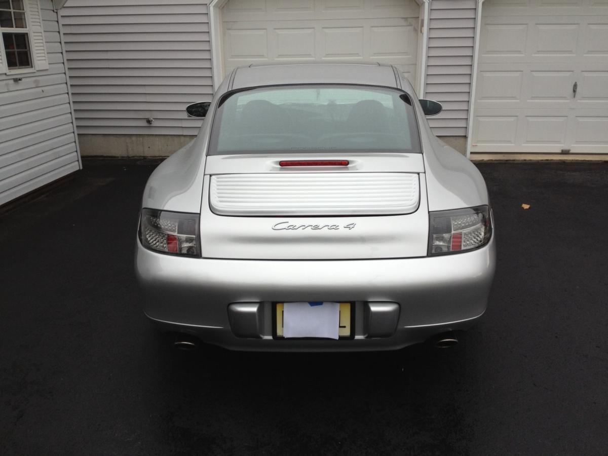

I added arctic silver painted bumperettes from bumperplugs.com to complete the rear end remodel. Love the color on this car; it's filthy and still looks great.

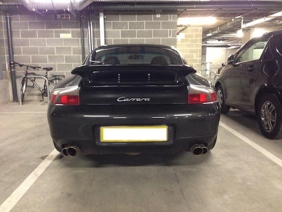

Hi I thought I would reply to this post, I bought and installed a set of Dectane LED rears for my 996 911 yesterday evening. Install was incredibly straight forward, one bolt removes the light and you simply insert and slide into place the replacement unit.
Both were installed within in 15 minutes including testing time. Please see below the pictures of my 996 before and after, the lights really freshen up the appearance of the rear of the car.
Only one issue I have and that is that only one fog light illuminates on the right hand side rear light. Im not sure if this is normal and expected or if the left light is faulty. Ill up date this post when I get some feedback from Dectane.
Hope the images are useful.
