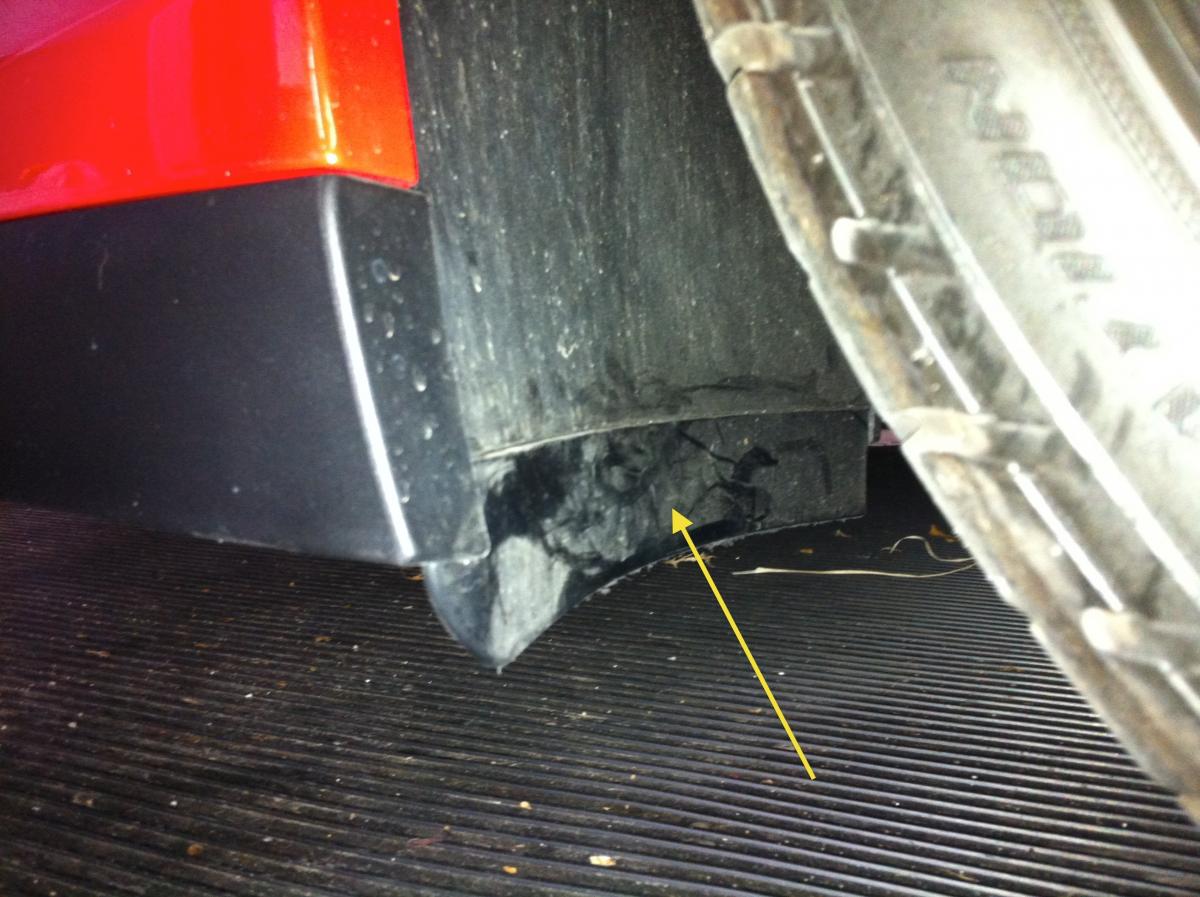

Does anyone know if this part is available separately?
Imprinted in the plastic trim are the part numbers
997 504 503 80
997 504 504 80
for the driver and passenger side respectively. A parts catalog search does not identify this part. Does anyone know if it is available separately from the front well assembly?

Could be but from what I can see on the picture in your first post - it looks like the wheel liner is damaged too.
Do you have a picture of an undamaged one?
I think it's only the bottom lip of the fender well which has scraped across the road. The fender well itself is okay.

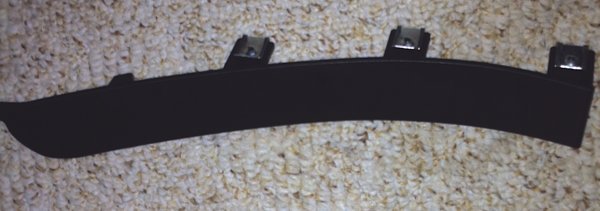

Just an update - the two part numbers I found are definitely the spoiler lip pieces needed. You do not need to order the entire wheel well cover. Cost $16 each.
997 504 303 80
997 504 304 80

The part number that is imprinted on the part does not match the actual part number. It was very difficult to find, and it was only after a vendor did an extensive search did I find the part. I still wasn't sure it was correct until it arrived today. In fact, if you look at the online parts catalog on Porsche's website, it is not even listed in the PDF.

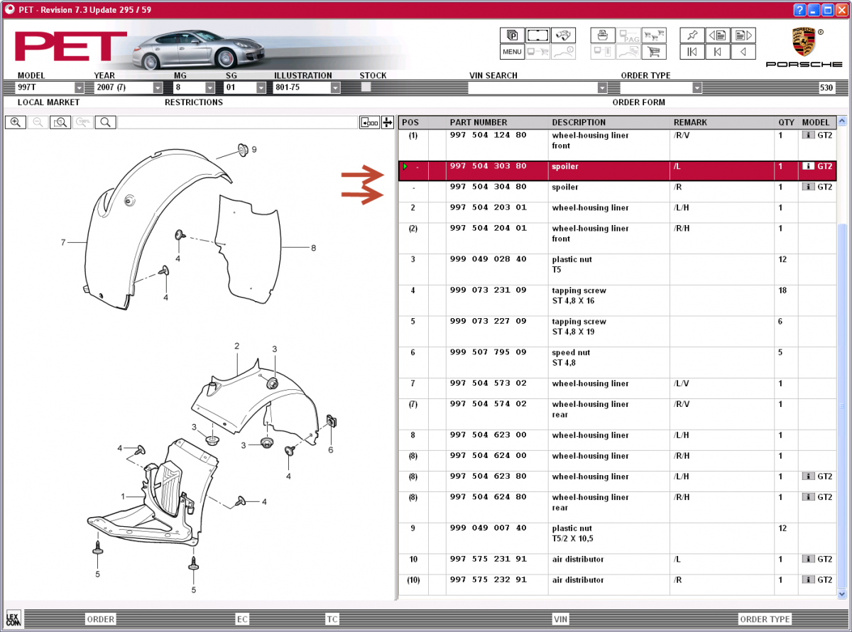

Here it is listed in Porsche's Parts System...
Hi Loren - that's exactly what used to find the parts. Someone had suggested the part number, I looked it up on the most current PET system, but it never correlated with a part that could be found on the picture - on the photo you included, it isn't shown on the diagram. Because it was fairly cheap, and I figured that "spoiler" was probably correct.
