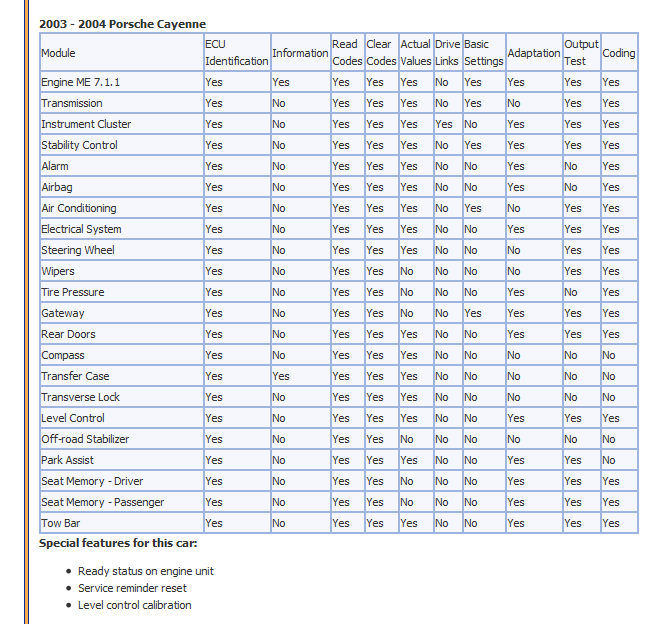

I have no experience with Durametric, but i doubt it will be possible.
I did it today and it was very easy. You must do this work in the Menu --> Vehicle Level Control. If you raise the values, the Air Suspension is lowering. Measure your original height and read the instructions, then follow the procedure until end, step by step. Don't forget to connect a battery charger.
