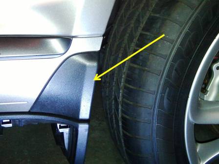

I am looking for the part number or name of the trim piece in the picture.
It is from a 2008 Cayenne S
Thanks, in advance for any assistance

Thanks for the prompt reply, but that appears to be the part number for the piece on the bottom. I am looking for the triangle.directly above that piece.
Thanks again....
Is it held on with two clips?
The parts diagram is from a different angle.
It is held on with two "molded in" plastic pins and then snaps around the wheel well.
Thanks again
Edited by brad34471
This "triangle" is a part of lower door molding. i was confusing porsche dealer same way as you did.
It looks like you are "facelifting 955 to 957", i did it myself recently. You would need to change those moldings assemblies (these alu trims are also different) on both rear doors to match those lower spoilers. Good luck
