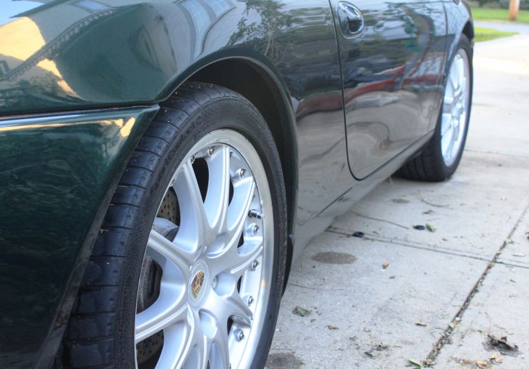

I need new rear tires on my 2000 C2. I have what's listed on the original sticker as "18" Lt Alloy Wheel - Turbo Look". These are the wheels shown in the attached photo.
The front wheels are 7.5J x 18, RO 50 with Continental SportContact2 N2 225 / 40 ZR 18 Tires
The rears are 9J x 18, RO 52 Continental SportContact2 N2 265 / 35 ZR 18 Tires
The fronts are fine, but from what I've read, the rears are for a Boxster, not a 911, though the tires are the proper size for a 911.
I bought the car from the original owner (a friend of the family) who is a very wealthy, spare-no-expense, let the dealer do everything, type of person. I don't believe there is any possibility that this person would have gone for a cheaper alternative with something like wheels.
So there are a few possibilities that come to mind.
1. Could it be that in 2000, 9J x18 x 50 rears were approved for 911? The TSB that I've read is dated June, 2011.
2. The dealer could have used a boxster wheel unintentionally or otherwise.
3. The car came from the factory that way (by mistake).
Now the question is "What do I do"?
I have a set of winter wheels/tires on the car at the present time (8J x 18, RO50 and 11J x 18, RO63)
1. Get new rear tires and have them mounted on the 9J x 18 x 50 original wheels. (which I assume have been on the car for 12 years)
2. Get four new tires and use my winter wheel set.
3. Look for a set of replacement rear wheels in 10J x 18 x 65.
I'm looking for the cheapest safe solution.

I don't recall Porsche ever offering 9 x 18 rear wheels for the 996. 9 x 17 and 8.5 x 17 rear winter wheels - yes but no 9 x 18.
I had a similar issue on my car when I bought it. I opted to trade them in for 8 x 18 fronts and 10 x 18 rears. Wheel Enhancement gave me a good trade-in price as the wheels were in very good shape.
I suspect that a dealer had swapped wheels with someone that really liked the ones on my future car.

Your original setup sounds like Boxster wheels 7.5" and 9". Also I have never seen "Turbo" look wheels that look like the pic in post #1. The wheels in post #5 look like "Turbo" look wheels.

I looked at the MY2000 brochure and you are correct. The "Turbo-look" wheels are somewhat similar to my winter wheels. My summer wheels are shown in the brochure as "Sport Design" wheels and are pictured on the GT3. I wonder if the dealer did this to "sweeten" the deal, only he used Boxster wheels instead.

Your wheels are the sport design. It looks like some how you got a boxster set. As far as the 265 size for the rear that will be a real stretch as you have a 11" rear. I think 265 is small on a 10" wheel. I would check to see if the tire you need comes in a 275/35 or if it come in a 295/30 it might be a slight bit taller, but it would fill out the rim better IMO. Your other choice is to get 4 new tires for the turbo wheels or trade in the rear sport design wheels for the 10".
