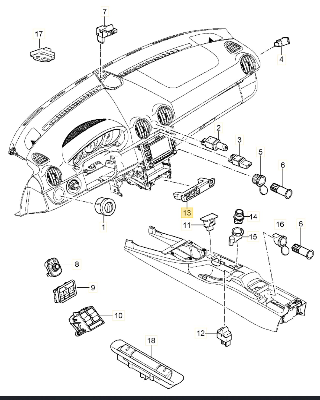

Yes, part thirteen. Mine has two switches on that module; PSM and Spoiler. Part number?

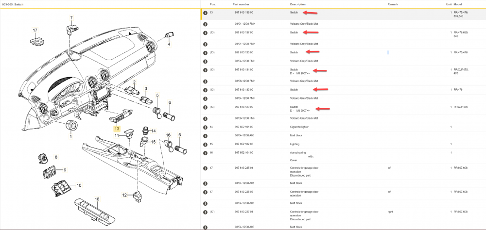

This Switch ( 997.613.133.00 FMH) is called a PORSCHE STAB SWITCH

There are 2 other versions of the Stab Switch depending on your cars options. When I submitted my order, there was a box to fill in my VIN. Based on the VIN, parts department selected the correct module with just the switches for the Spoiler and PSM..
