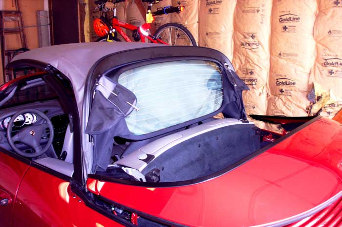

The best way to clean the inside of the rear window is to flip up the back part of the top.
To do that:
1. Open the top part way to expose the bottom of the back of the top

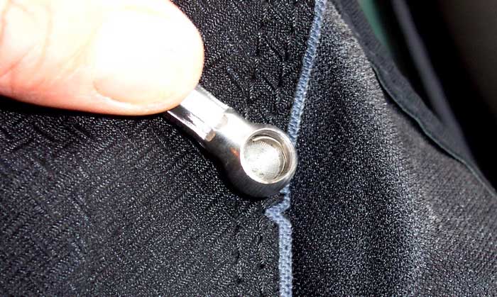

2. Next find the 2 wire rope assemblies on the left and right sides of the bottom back corner of the top.
3. Next pop off the ends of the wire ropes:
4. Lift up the top to get at the inside of the rear window.
My car is an 2002 with a glass rear window, but the plastic windows work the same.
