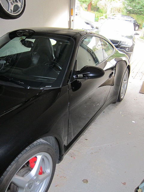

Here is what I mean with the smaller 295 tires in the back, despite the fact that it is an 11 width wheel, it looks like it is not taking the full space
You can see that the car shines, just polished it and waxed it this week
