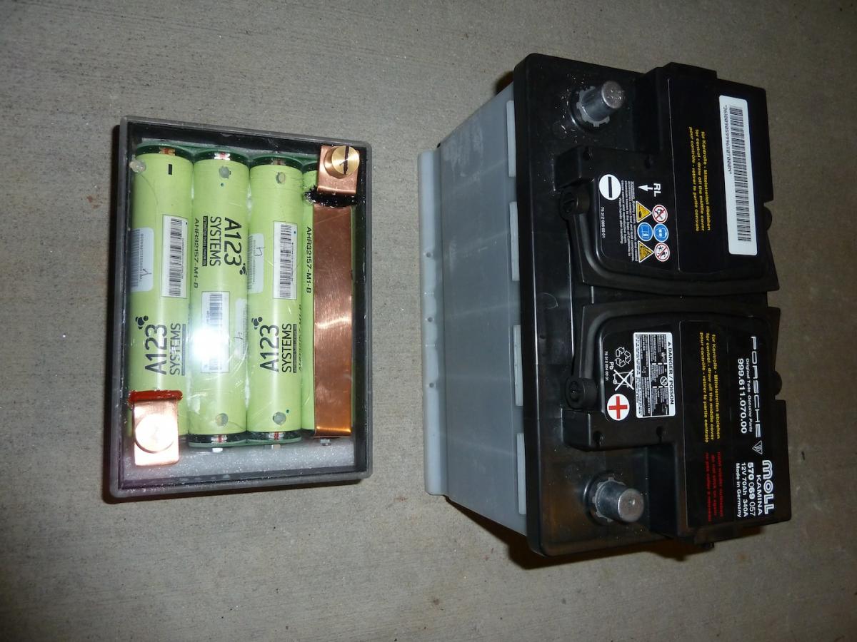

Hello all, I installed a new lithium battery today. I can't say much about how good it is yet. I can say that it starts the GT3 no problem.
The OEM battery weighed in at about 42.5 pounds.
The Lithium battery weighed in at just under 6 pounds.
Very nice weight savings. :)
I had the battery custom built by a guy at Lithiummoto.com.
The guy is very knowledgable and helpful. His prices are much better than the big brands. The battery was $600. As you can see by the pics, he hand builds these batteries. So if pretty is your thing, then you might not like his stuff.
I know what a lot of you are going to say about taking a chance on an unproven battery manufacturer. I have done my research and I know a good bit about batteries so I am will to take the risk.
I will keep updating this post as I get more time and miles on it so everyone will be able to follow it's reliability.

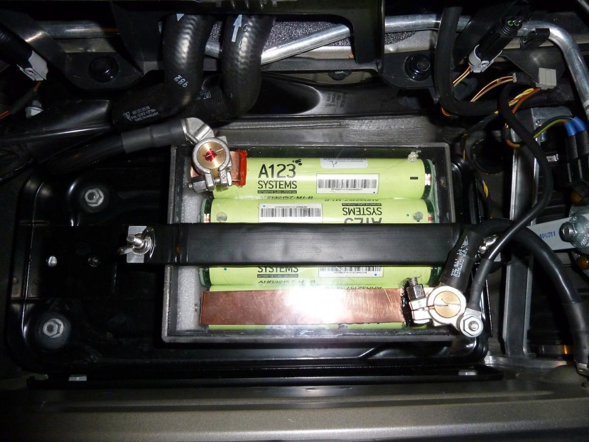

post-28708-0-49714100-1324693587_thumb.j
post-28708-0-44964700-1324693662_thumb.j
post-28708-0-03593200-1324693694_thumb.j
The top 2 pics are the mods I made to the battery tray. Just all-thread and aluminum flat bar with heat shrink around it. Fits perfect and fairly easy to do.

Yes, I checked it while it was running and it was maintaining 14.5 volts. With the car off it was holding 13.5 volts. Lithium batteries charge much quicker than lead and they hold a higher voltage too. The only problem with a battery this small is that you will need to keep it on a battery maintainer if the car is stored for more than a few days because it doesn't have the reserve capacity of the large lead battery.
Yep. The Porsche battery is very nice in every way but it's not $2800's nice. It also weighs 12 pounds. The next cheapest lithium battery I found that would start my GT3 is $1050. It has a prettier package but it does exactly the same thing.
