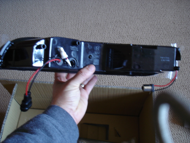

Would like to see the connectors on the back also before you 'slap' them in :-)

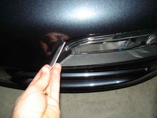

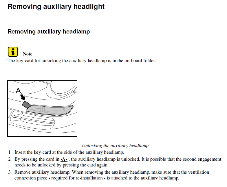

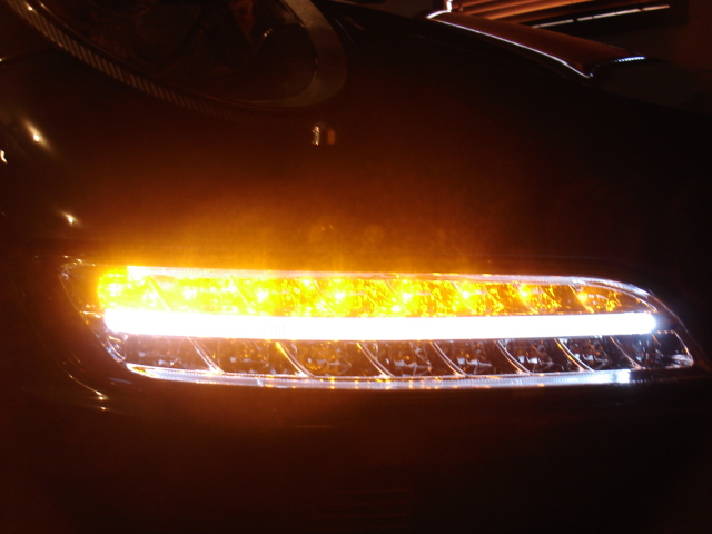

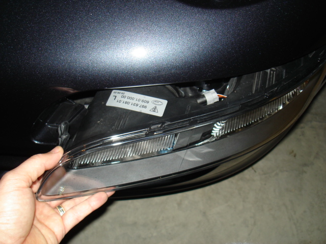

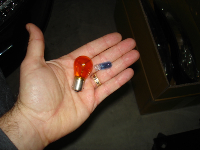

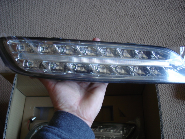

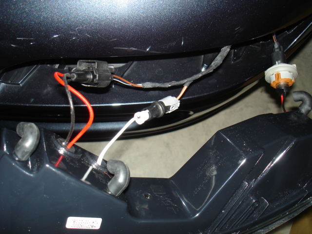

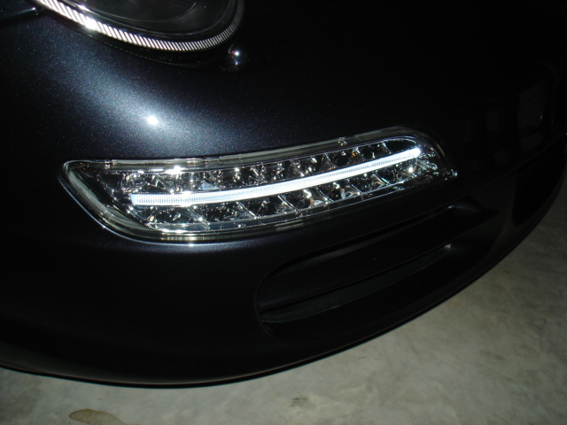

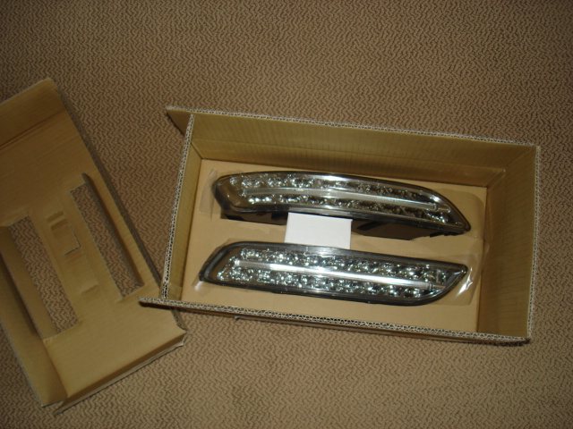

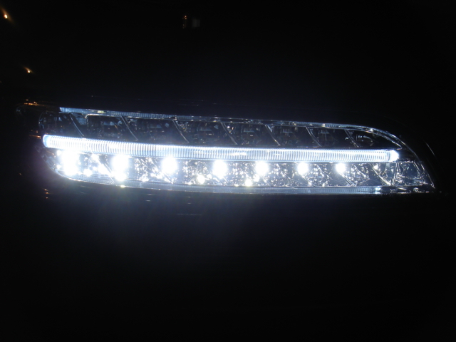

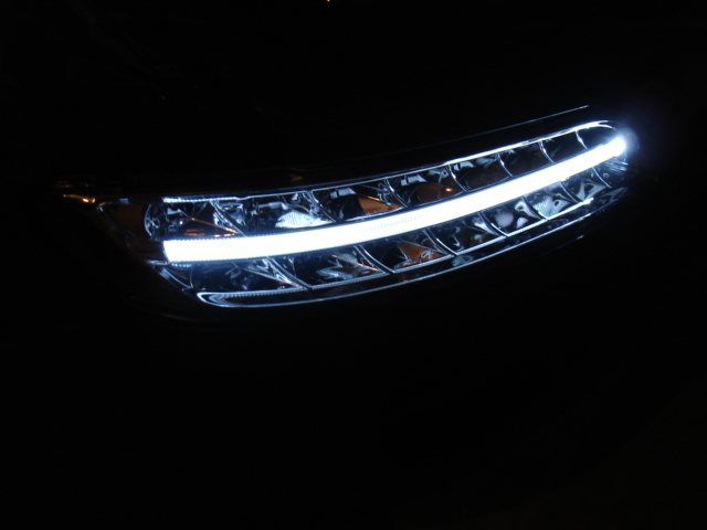

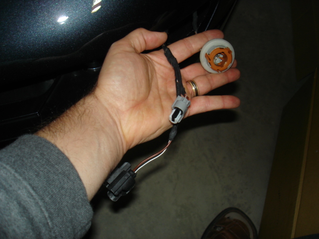

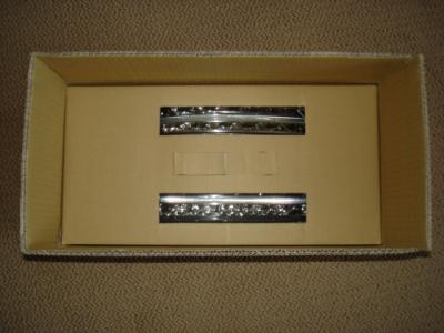

I received my Rottec DRLs yesterday. I'm very pleased with the lights. As promised, here are some pics of the install. Basically, to remove them all you do is insert the card tool as per the owner's manual. Push in once and pull out the assembly a bit, then push in again and it will release. Pull it out and disconnect as per the manual. The only trick is that the fog light bulb and connector need to be removed from the original housing after the wiring has been disconnected. Then you re-use the black connector that the little blue bulb was in. It really couldn't be easier.

Very cool and BIG BIG THANKS for posting the photos.
How would you rate the quality of the RO-TECs?
They look awesome BTW :-)
You're most welcome. The quality looks very good from the front. The connections on the back of the assembly are not as good, IMHO, as the OE, but still very good. Based on what I've seen so far, I'd recommend them. But I'm far from an expert. I can say that Ray at Rottec has been great to deal with so far.
