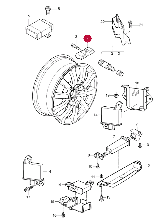

Anyone know how hard this is to do ?
The 08 I just got has new frequency so my winters will no longer work
Porsche recommends new valves with the new sensors.
Basically the tire has to be deflated and the bead broken enough to get your hand (and a wrench) inside to replace the sensor and bolt.
if I am thinking about buying an extra set of rims (OEM or other brand,) can I simply buy the TPMS parts and have my tire shop install when they fit with new tires? Is the TPMS part number for cayenne: 955 361 053 00? Are there other parts I would need? Just curious as I was thinking of getting these right off ebay. I have a 08 CTT.
