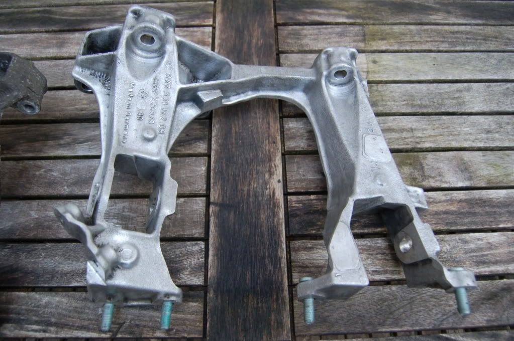

Thanks for the link, logray. I'll definitely look at that part. Loren - do you know if there are any major challenges to know about ahead of time if I try to replace this part myself. It appears that it is just a lot of unbolting and re-bolting. I'll use fresh screws and nuts and get an alignment afterward. Also - do you know where I could find the appropriate torque values for the nuts?
If it's this then it's readily available second hand and is easy to replace. There are two studs that go into the shell that need to come out (They sometimes come out with the two nuts attached to them) and you need to unbolt the rear anti-roll bar (swaybar) and the control arms hat are also attached to it. The 4 studs in the lower end can be punched out if it helps access.
It also has two bolts holding the gearbox mount onto it along with another 2 that go into the black crossmember, remember and support the gearbox and engine!
