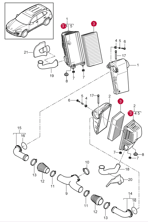

Pretty much the same as the earlier models - http://www.renntech....-filter-change/
Two paper cartridges (item 3)

Not the Snorkel kit but for the older Cayenne's (V8's) Porsche had a heavy duty filter option with a foam pre-filter that could be cleaned in order to extend the life of the paper element filters.
Correct option I1L2
I believe the filter and housing were different.
