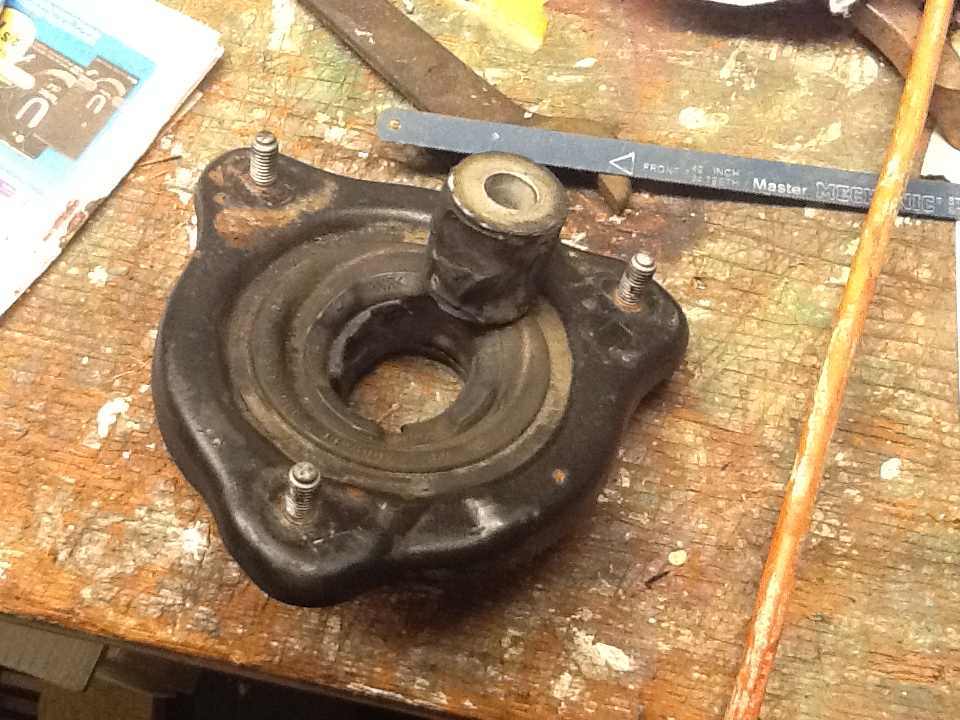

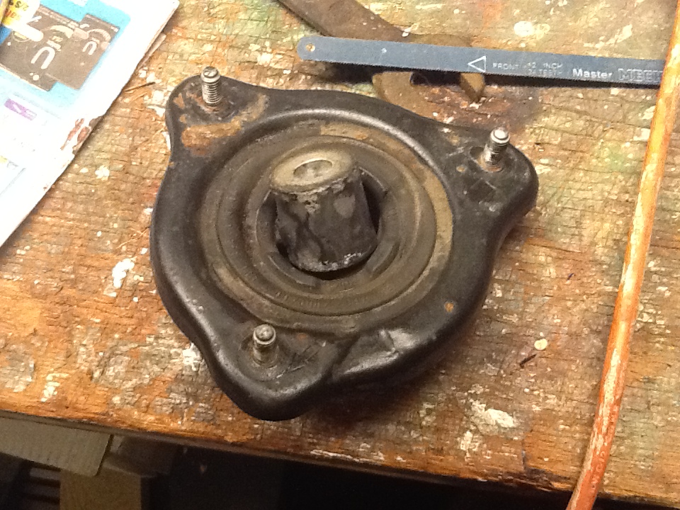

Just had to replace my upper strut mounts on my C4. The mounts are the same on the C4,C4S and Turbo in the 996 series. They seem to have changed with the 997 series, at least a different part number and a lower price but I don't know if they are compatible. Here are pictures of one of the upper mounts out of my 12 year old car.
post-7011-0-09716200-1334002781_thumb.jppost-7011-0-62621600-1334002797_thumb.jp
When I put my PSS10's in about 2 yeras ago the mounts looked fine, but this one had certainly failed. I have not disassembled the other side yet but ordered each side (they are different). I had a very loud clacking sound, and now I know why. The mounts list for about $237@, got them from Sunset at $145@ in stock. I actually thought about the Tarret Engineering Monoball mounts, which just came out for the C4, but they were $499 asnd I don't track my car.
So if you are having some noice in an older car you might want to check your mounts. I could not see any problems until I actaully took the struts apart.
