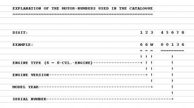

For 9x6 series engines:
(click to enlarge)
Porsche's PET parts system has more information but the list is maybe 20 pages long (too long for here)
For your engine M96/20AT65X65895
2.5 liter Boxster engine - 65X says the engine was manufactured in 1999 and was rebuilt at a later date.
