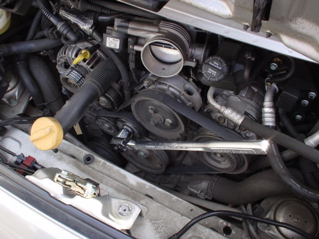

This is a 996 recent belt change. Takes a few minutes on a 996 because you do not have to go through a service cover.

No, the Boxster and 996 does use a rubber belt, but not for the cams as those are driven by chains. On a Boxster think of it a a fan belt with a fancy name.
I just did the poly rib belt took all of 5 min to change out using Loren's instructions on the DIY section. Got the part at the following site.
HTTP://WWW.THE-BEST-SOURCE.COM
1x #W1000-84690/W1000-84690 Multi Rib Belt= $37.10
The old belt didnt have but a few cracks anyway, cheap insurance & keep the old for emergency.
