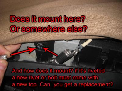

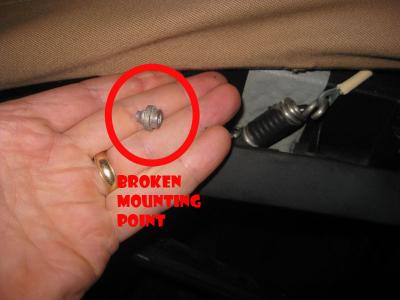

I have a '99 996 with both sides broken at the rivet point where the spring attaches. The rivet rattling around in the channel but I can't figure out where it was attached and how to reattach something to hold the spring. Ideas? Of course, without this cable functioning, the top is very loose and pulling in as described in this thread. This is likely the same issue that other folks are having.
post-57968-0-33547500-1324563228_thumb.j
post-57968-0-67228200-1324563237_thumb.j
