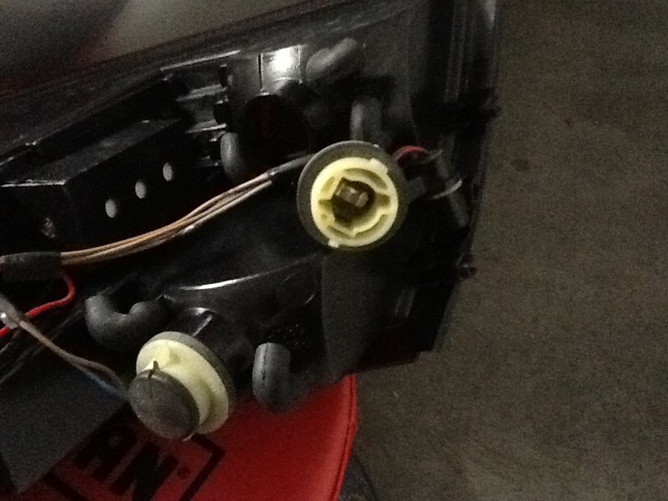

I can verify that all the lights will work without plugging in the fog leads on the LEDs. The fuse will blow for sure. The only bulbs I used were the backup bulbs. The empty sockets (where the rest of the bulbs would go) plug into the LEDs. I don't ever use the rear fog so I didn't really mess with that portion. I will try to get some pics posted up tomorrow unless the OP beats me to it.

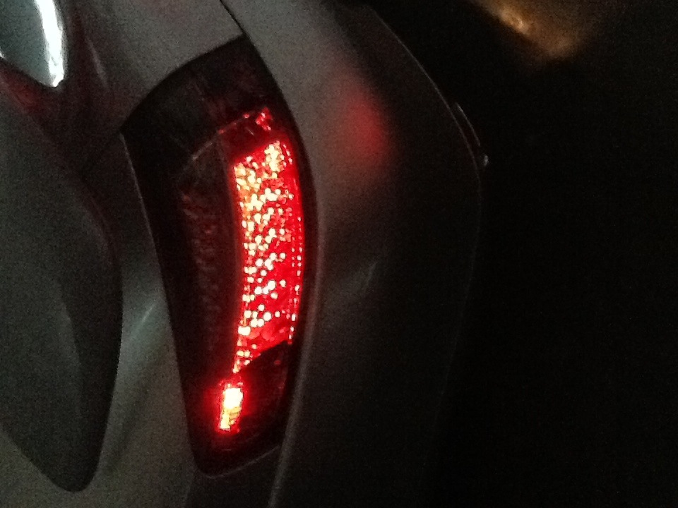

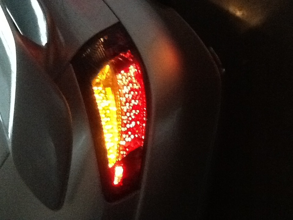

Here are a few pics I just snapped with iPad so not the best quality.
Running lights on. Couldn't capture brakes by myself. Turn indicator activated.

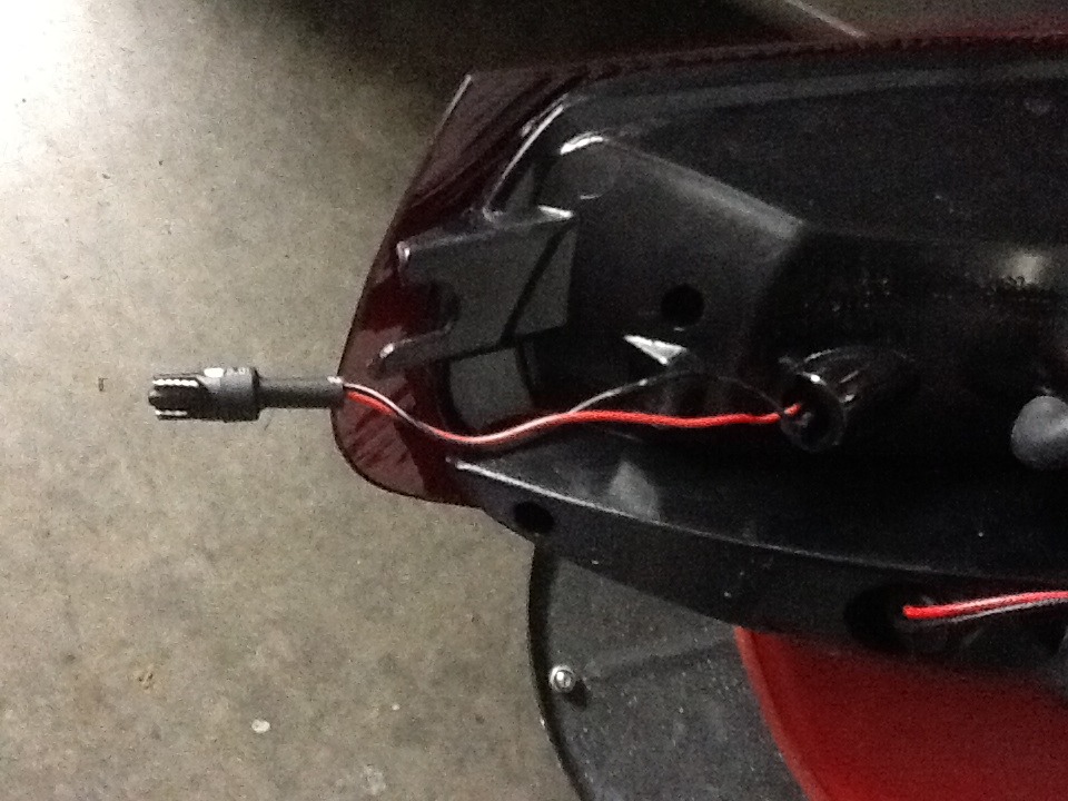

The skinny wire is the one that will blow the fuse if plugged in.
To continue, the female ends of the brake and running lights and reverse lights plug together with the silver male ends of the LEDs...I left one unplugged so you can see. The unused white female one shown is for the fog light. I dont use it so I just leave it empty.
Thanks for the photos and info! This is the first time I've actually seen this. Do you know what that unused skinny wire is for? Is it just a mistake in design?
I really have no clue what the skinny wire is for. It makes no sense to me either. I assume that the skinny wire on the stock lights is the main power feed? The LEDs power through the bulb receptacles so there is no need for it.

I installed these earlier this year after reading every thread I could find on Rennlist and 6spo. It took a while for me to understand what was going on with the side markers and blown fuses. And you're right, it happens because the original bulbs are not polarized, but LEDs are.
The problem is that the "skinny wire" (the wire for the side markers) has a plug that can be connected either way. You have to look at the wires and make sure you connect red to red -- that is, you have to connect the red wire of the wiring harness to the red wire of the side marker plug. This ensures that the polarity is correct.
If you do this, it works OK -- at least, it did for me. If you connect it incorrectly, you'll blow the fuse.
