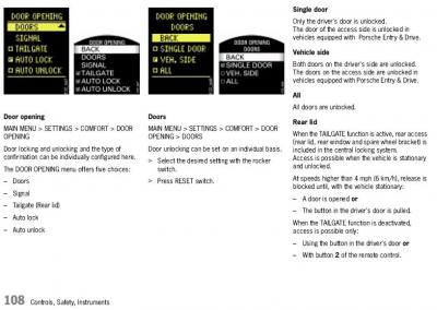

Hi -- for the glass rear hatch/lid release using your remote: hold the lid release icon down on the remote for a second or two -- a longer time then you think may be normal. Then the glass lid should pop-up 1/4" to 1/2" and you lift it up.
A cool feature is if the glass lid is up and then you open the main hatch the two will connect at the top and you only have to close the main hatch, not both.
Also, if you want, search the DIY and you can find info on how to have the main hatch behave the same way as the glass lid -- pop-open 1/4" to 1/2" and then you lift it up.
If you do this, be sure to set your unlock settings up properly so you do not pop the rear hatch every time you open the doors. Attached from the '04 Cayenne S manual explains the setting options.
