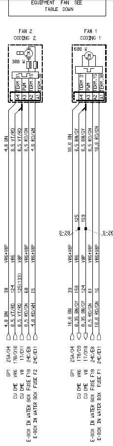

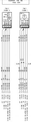

2. How are the fans triggered? From descriptions it appears to be controlled through the motronic, but the circuit diagrams show a fan control unit - without any inputs from anything.
3. Anyone know where the fan control unit physically is?

Loren, thanks for the diagram, I passed it to my mechanic.
Wvicary - he tested the fan by unplugging it from the car, then hooking up a battery to the ground and power feed wires. No trigger voltage - the fan started up and eventually reached full speed. His feeling is the speed control module on the fan has passed on and it needs a new fan.

BTW - the old fan and the new fan both have 4 wires coming from them (and a 4 wire plug).. it isn't clear by the diagram above if it's showing 4 or 5 wires.. the two wires going to the 2nd connector appear to be alternative wires (one for V8 and one for V6).. so not sure how accurate that diagram is.

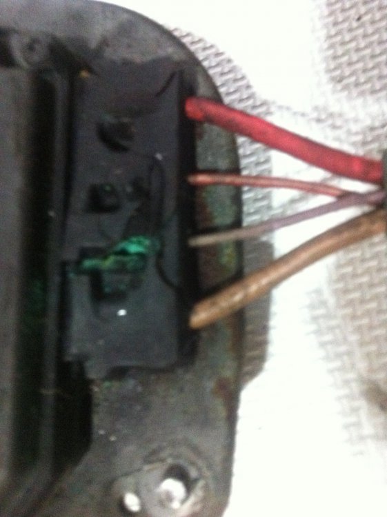

A new fan fixed it. Tried to disassemble the old one to see what cooked, but it's sealed up very nicely. Lots of electrolysis noted around where the wiring goes into the electronic box on the fan motor. I guess putting the connector at the top of the motor seemed a good idea to someone..

Ditto for me, also replaced the fan and it fixed the problem, there was a crack in the connector on the control unit on the back of the fan motor where the wiring harness enters it. Green oxidation was clearly visible once the fan assembly was removed from the vehicle. The quality of this expensive part is disappointing, shame on Bosch, V.W. and Porsche for not making this better. I have much older American and Japanese cars with more mileage with dual electric cooling fans that have not had any problems with the fans. The part number is 0130706202 by Bosch approx. CAD$520.00 not cheap!
