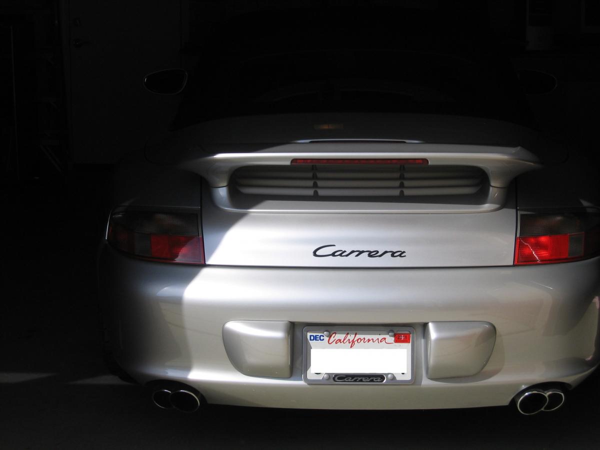

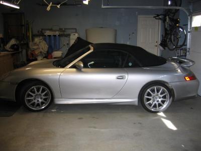

Here are some pictures of my car with the Aerokit spoiler and side skirts. I painted the parts myself with PPG water base (base paint) and PPG urethane clear coat with hardner. It cost me $200 for paint and materials. Most of the body shops wanted $2K to paint. I used a HVLP gun.
Total cost for this mod:
Aerokit spoiler $925 (got $575 credit for damaged deck)
Aerokit side skirts $678
Paint & supplies $200
Labor FREE
TOTAL $ 1,803

The spoiler and skirts are Porsche OEM, and I believe that they are polyurethane.The only OEM spoiler that will fit your cab. is the one that I have. It's called Carrera rear spoiler P/N 000 044 802 04. The spoiler comes with a front lip that mounts under the front bumper.
I see the OEM spoiler time-to-time on eBay ($2K-3K). A new spoiler would be out of the question, as the retail cost is about $7K. If you go with aftermarket, you have more options in terms of style, i.e. GT3, taco, or other. You will pay between $1500-$2000 for a quality wing.
You can purchase the OEM side skirts from Sunset Porsche for $678. I have seen them used on eBay for $400-$600, but my feeling is that it's better to buy new b/c you will have all the mounting hardware and body tape to mount.
