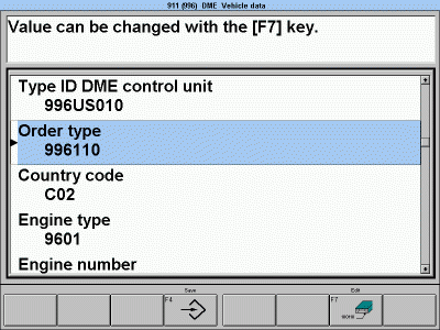

The part number of the both alarm units and DMEs are the same. The alarm unit says M535. However, Durametric does report a different country code and order number for the canadian DME and my original DME. I am not sure if that is important. The order numbers are both '996<something>'.
The air bag unit does show a fault in the driver's belt buckle, but I assume that is because I have the driver's seat removed from the car. Do you think I need to plug the driver's seat back in? I tried this once two weeks ago before I had the Durametric cable and it made no difference, but I hadn't cleared the codes at that time.
Sorry I don't have a screenshot, but I can say that the Durametric shows a green checkmark next to DME unit, a yellow exclamation point (but no fault codes) next to the alarm, and a red error code on the airbag unit for the driver's belt buckle.
About further water damage, I'm not sure where to look. There are no fault codes to investigate. Do they take some time to show up? I feel that the starter relay bridge test rules out the ignition switch, starter, and solenoid. I can read codes and actual values off the DME/Alarm/Airbag units, so its not like the cpus aren't firing up. I'm slightly worried that the canadian units aren't the same as the US units, but then I find it hard to believe that would be the case considering the part numbers are identical.
Do you guys think it is a valid idea to get someone to program my original US DME to bypass the immoblilizer? I read this was possible in another thread on here. If I wasn't at work I would dig it up.
Here is your order type and country code. The only think this might prevent is proper coding of options or changes to options.
Any airbag code needs to be cleared (they will not clear on their own). And, the problem must be fixed to clear the code.
You can not re-program the DME to by-pass the immobilizer (at least not easily).

Order type is the model "996" and the body type "110" is coupe.
So for MY1999...
996110 = LHD C2 Coupe
996111 = RHD C2 Coupe
996310 = LHD C2 Cabriolet
996311 = RHD C2 Cabriolet
996410 = LHD C4Coupe
996411 = RHD C4 Coupe
996610 = LHD C4 Cabriolet
996611 = RHD C4 Cabriolet
