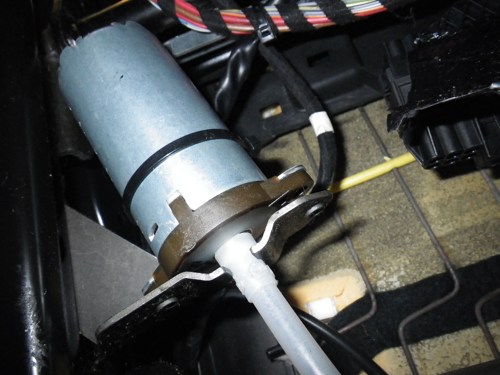

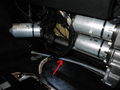

There is no obstruction under the seat, but I found what it look like a small plastic tube with a metal wire in it. One end of this ''tube'' is loose.
Probably a part of the problem ?
  On 9/21/2011 at 1:16 AM, 996-99 said:
  On 9/21/2011 at 12:57 AM, Loren said:
Step one - check for an obstruction under the seat.
Thanks Loren for the fast reply :)
Here is a pic !
post-71449-0-81327400-1316568510_thumb.j
That is the cable drive from the motor to the seat. It has come loose so you can here the motor working but the seat does not move. Happened to my buddy on his car. On power seats there are three or four motors, one for the fore and aft movement, one for the backrest movement and I think one each for the front and back of the seat bottom to raise and lower them. From each of these motors there is a plastic sheathed drive cable. The end of the cable are square and fit into the motor and the gear mechanisms on the seat. There can come loose and/or break. The part number is 996.521.609.00, list price $23.78. You have to take the seat out to get at these motors and cables. Sometimes you can fix the attachment by often you have to replace the drive cable.

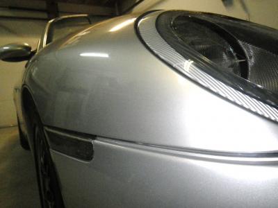

Finally done !!! Here in Quebec, March 15 is the first day that you can use your car without winter tires. So it's out on the sun :thumbup:
Beside changing this cable for the power seat, I also got rid of these orange side markers :D
This is only a small change but the look is 100% improve !
post-71449-0-03386200-1332208627_thumb.j
post-71449-0-63651000-1332208652_thumb.j
post-71449-0-74634800-1332208667_thumb.j

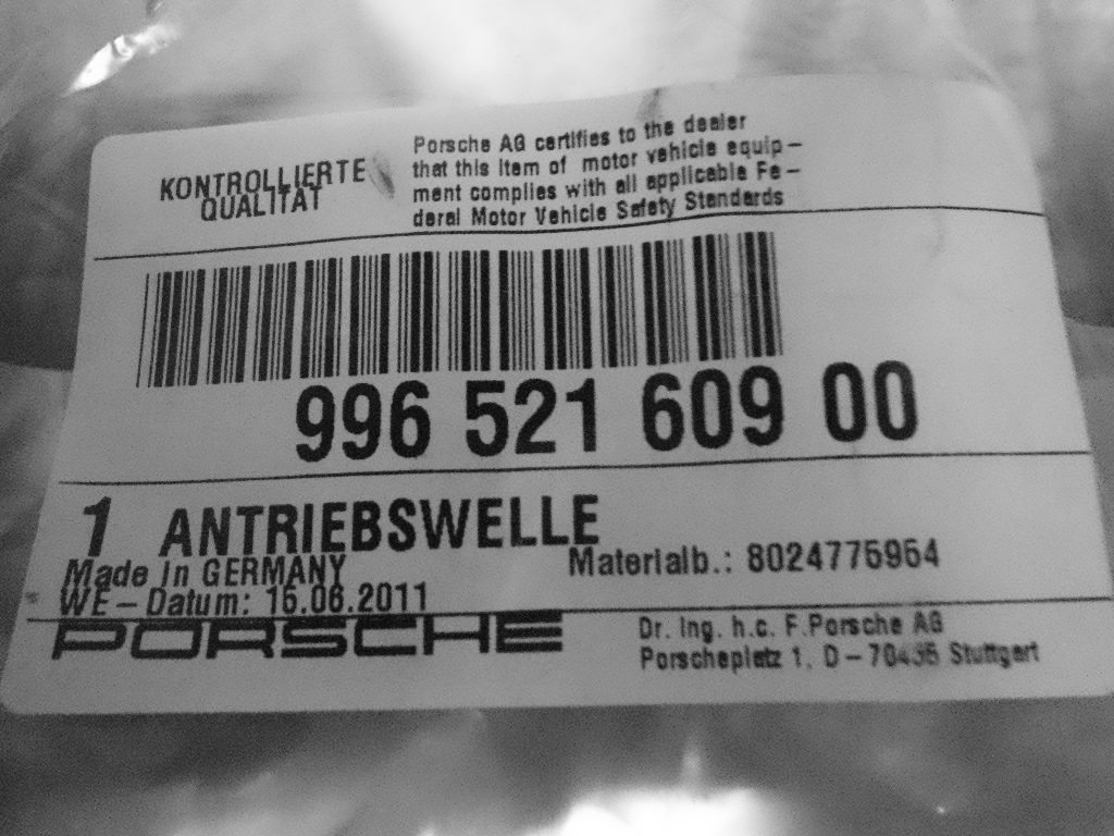

3. The part number listed by Dharn55 996.521.609.00 is correct. I paid $24.97 for it at the local Porsche dealership. Normally I order parts online but this part appears to be special order from Germany so it was actually the same price online.

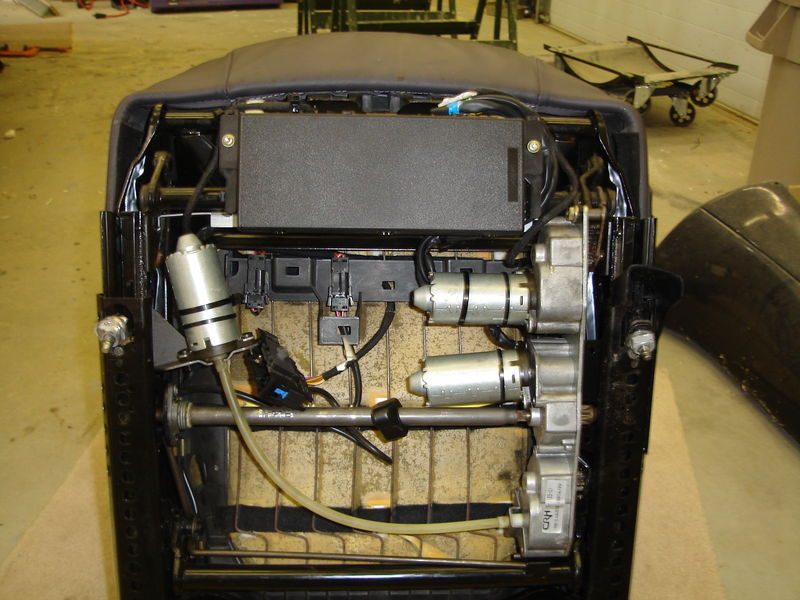

4. I attached a picture that I found online which I found helpful to understand the controls of the seat. The person that took this picture has obviously taken the seat out of the vehicle (which, again, isn't necessary) but it's a useful picture to orient you to what you're trying to do. The front of the seat (the end closest to the front of the car) is on the floor in this picture. In my specific case, the cable running from the motor on the left was missing (previous owner must have known about this issue but didn't fix it). The right-end of the cable in the picture is attached to the seat gears with a metal clamp (this comes with the part) that you can see if you expand the picture. The left-end of the cable that screws into the motor does not have a metal clamp like this, but rather is held in place between the motor and the metal bracket it attaches to on the seat. The torx screws that hold this in place were much more difficult to get to, especially the one on the left of the motor in this picture....until I got the idea to use the torx bit and a wrench. This was necessary because you have to unscrew from a 90 degree angle because of the way the motor is positioned. You wont be able to unscrew it from the top down, as you normally would, because it is obstructed.

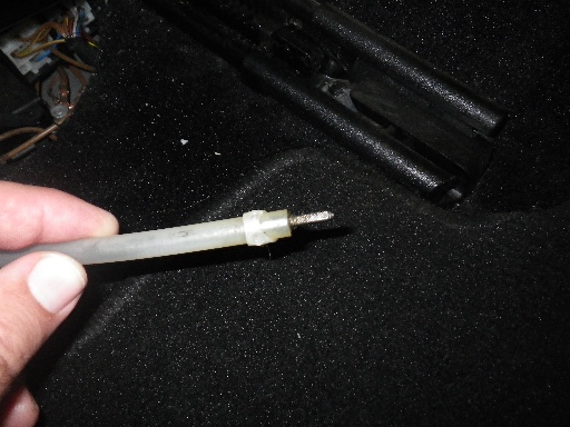

This cable that was replaced is simply a square drive-cable sheathed in white plastic. As soon as I replaced it the up/down functionality of the passenger seat now works again.
