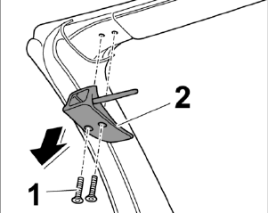

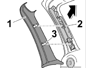

Removing the A-pillar trim (987)
1. Unscrew fastening screws 1 from the convertible−top peg housing 2 .
2. Pull A−pillar trim 1 inwards along the windscreen frame 2 in direction of arrow.
3. Remove A−pillar trim 1 upwards in direction of arrow.
