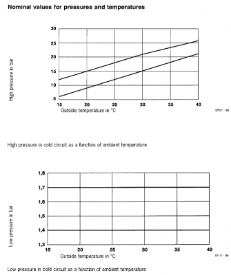

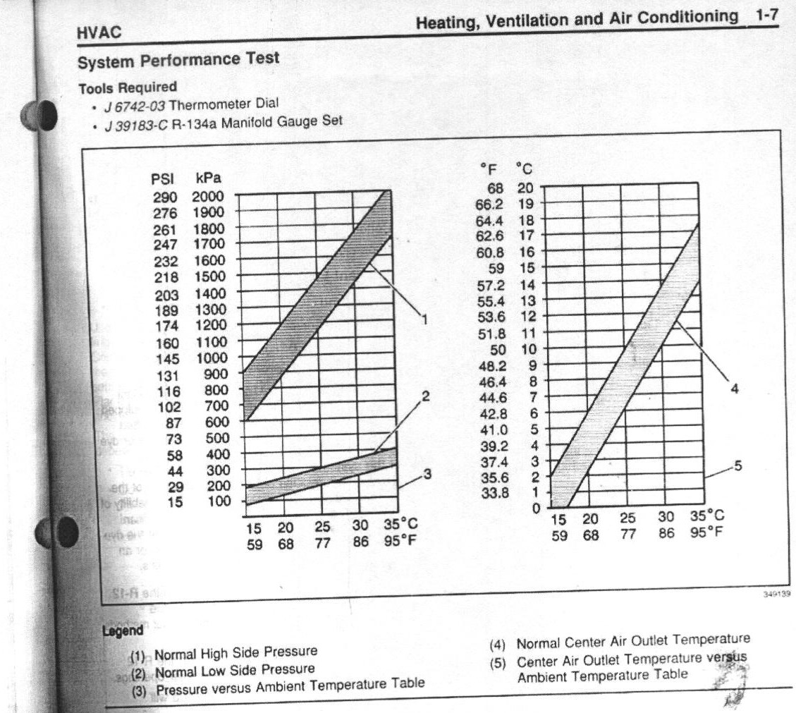

I found on the net the data sheet below that is very interesting for those who want to diagnose their car A/C.
post-20096-0-67767100-1317642652_thumb.j
