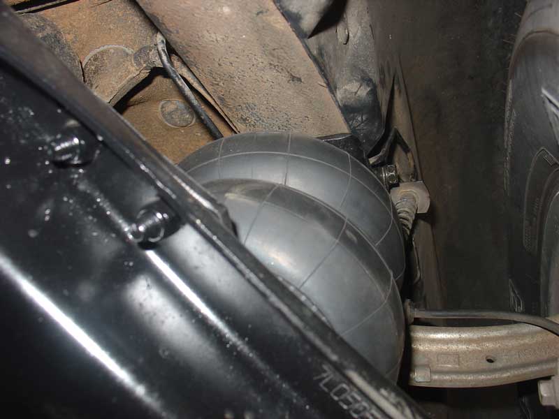

Thought I'd post some info from the Toureg side. I have done much research there yet, but it looks there my be some guys trying.
I'm not a fan of cycling the suspension for lift as it does reduce down travel, but it looks like they have tried 35mm spacer blocks and 265/65-17 tires. Another pic showing air bag.
