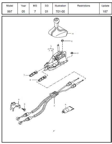

Just pull it up from the front and then move it forwards. After that there is a lock nut which you have to turn around 90 degrees and then pull the shifter knob up.
Here is a picture.

Paul, I need to know how to change the boot. Seperate from the plastic nut etc. Thanks!
