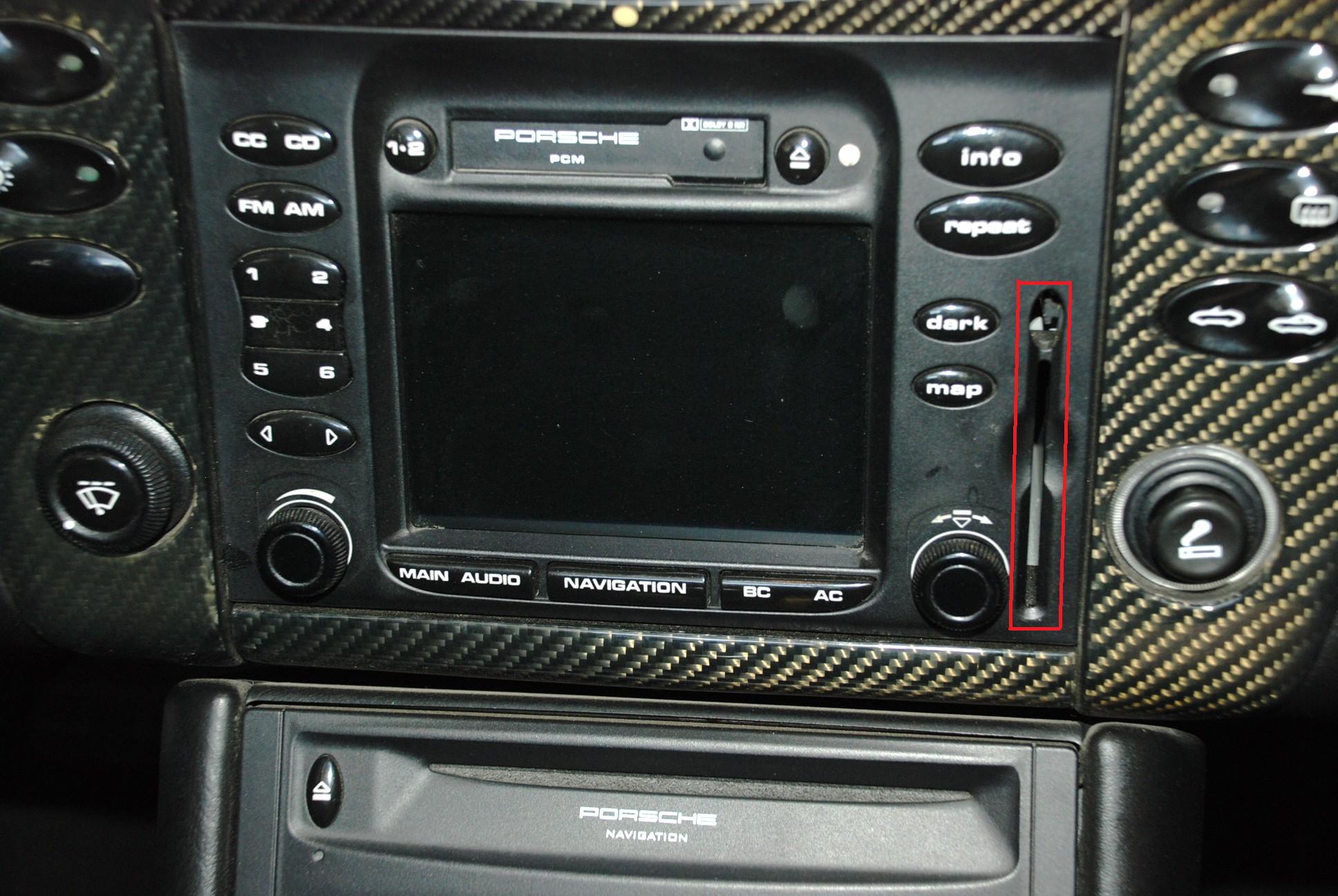

Hi. I know that I need the serial number of the radio to have the code, but how do I remove that radio? My radio have a little cover that I can take off. Do I have to insert some tool inside that? You can see on the pictures.
My car is a '99 Carrera Cab with navi option.

BTW what is the slot behind the cover on the PCM ?
Mario

For the slot behind the cover on my PCM...what is it ?
Mario

Optional SIm card tray.
I don't think US and Canada got this option as it was not popular here at the time this was made.

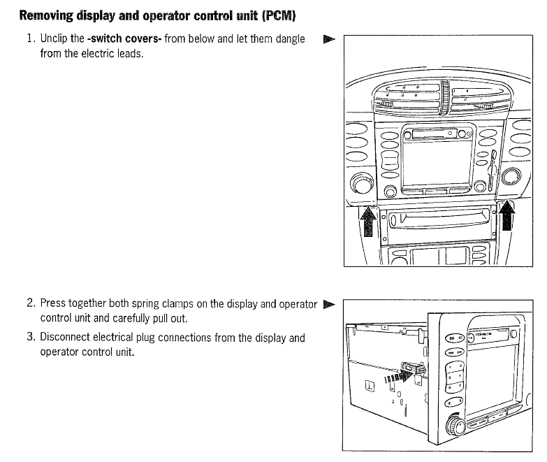

I think Dharm55 read your title literally "radio". You have PCM which is a NAV unit with the radio built in. Use this procedure to remove it. attachicon.gifpcm1.png

I'm trying to remove my PCM 2 unit and have found posts that reference the hex wrench and detents that need to be pivoted and then I saw this diagram
that Loren posted a while back.  I have pivoted the detents, actually pivoted them right out of the radio so I know they are not providing resistance.  This
is the first time that I have seen reference to a spring clip that needs to be pressed and it seems more in line with what I am experiencing.  I have a 996 TT,
am I at the stage now where I just need to squeeze the tabs (that I do see) and pull the unit out ?  Pressing in the tabs and pulling seems to exert force on the
remainder of the surround,the top vents and cup holders etc ?  Maybe I'm not pushing in hard enough ?  I saw a post that discussed removal of the vents ?
I saw other posts referencing those european radio removal tools/keys but I don't see any place that they could be inserted, defiantely no pales to insert from
the front.
Any Thoughts would be appreciated !
