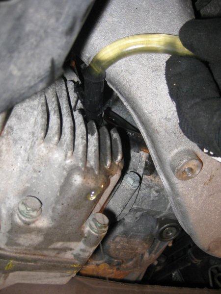

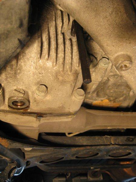

Was really easy to do other than trying to get at the fill plug for the front Diff. My socket wouldn't fit and I happen to have the correct allen wrench. Huge difference in sound...

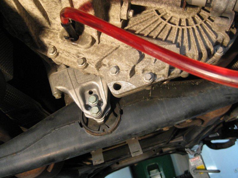

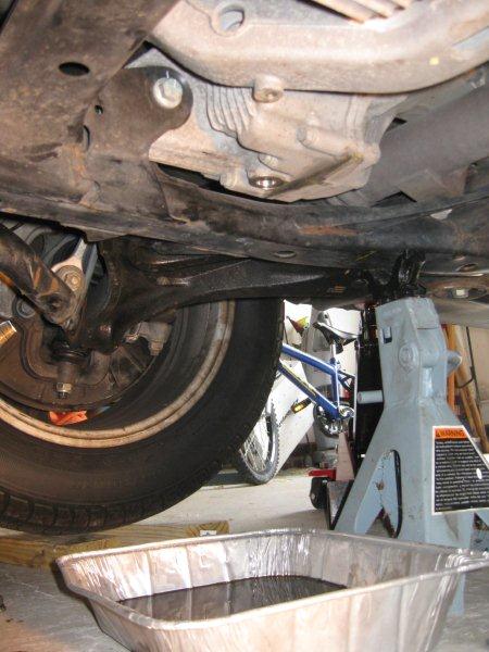

Question: I have the noisey differential problem and wanted to change the fluid to see if it helps. I see you removed the top drain screw. Did you have to remove the bottom to drain as well? Please tell me the difference between the bottom and top tubes. I would guess the top tube you are filling the diff back up but what are you doing with the bottom tube? And as vicary asked: fluid, amount and cost?
Its realatively easy to do. The top pictures are the front differential(clear gold fluid) and the bottom ones are for the middle transfer case(red).

Front Diff-about 1 quart
Transfer Case-about 3/4 of a quart
Rear Diff-about 1 1/2 quarts

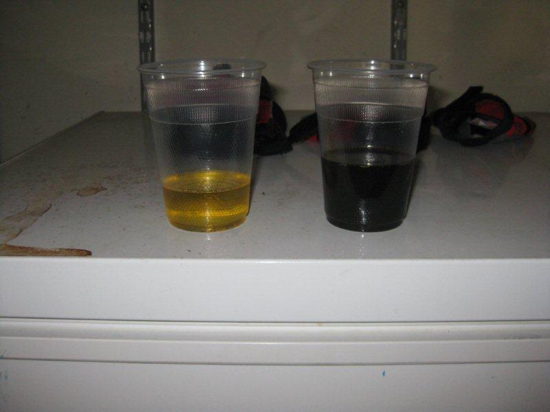

Hahn...I was really surprised how bad my diff oil was. I have 100K on my '04S. Porsche recommends 120K change on the Diff/Trans if I am not mistaken. I am going to do the transmission/filter in the next two weeks and will take pictures as well. BTW how do you like the redline? I have never used it...Used to use Royal Purple but found I like AMSOIL better...

I drained front diff this weekend. Very little fluid drained out! No wonder why it was making noise. The lack of fluid I am sure didn't help my diff problem. I also had to grind 1/4 inch off of my allen wrench to clear the piece that was in the way. I would reccomend doing this MUCH sooner (50 or 60K). I have 120k miles 2004 CS
