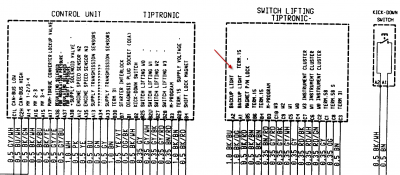

Hello, does anyone know where the backup light relay is on an '01 Turbo with Tip trans? There is a dozen relays under the driver's dash and few in the back seat by the ECU is it any of those? Thanks.
On the Turbo, the reversing light switch is on the base of the selector. It is part of the multi-function switch, and can't be changed separately. As far as I know, there is no relay.
post-4000-0-25661400-1314206487_thumb.jp
