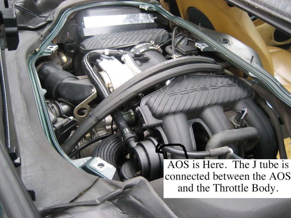

I think a little white smoke for a while is typical. It is also a good idea when replacing the AOS to replace the "J" tube that connects from the AOS to the throttle body.
I replaced the oil fill tube, and the j-tube. After work it smoked more than ever on startup. Its really embarasing.
