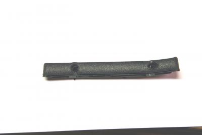

BTW I figured I would comment since I have done the mod and noticed some important additions needed
If you take off the vents and work from the passenger vent with a flat head screwdriver prying off it will pop out and or break. Then you can push the screws back through the holes and pry in that groove and break along the way till you're done. Follow this process from the passenger side as you have removed the center trim and then from the drivers side on the last piece by the drivers vent
NOW the most important part. PUSH all the areas around the holes back down as they create ridges around the holes and will not let the piece fit flush. Then use clear silicone with a Q tip to spread the silicone along the grove and insert the new pieces
The result :)
One twist that saves a bit of time is instead of "peeling" the layer off the strip is to get the new strip, align its screw holes over the old strip, mark with a felt tip pen and drill throught the layer at each screw hole location. Then, use the soldering iron as noted above. :)

I just want to report that I have completed the three piece dash trim strip mod with carbon fiber. I was able to reach all the torx screws without pulling them out. Removing the steering wheel and the upper center console was NOT required. I did remove both air duct end pieces for access. I also removed the instrument panel and the "horseshoe" under the steering colume. You also have to remove the air duct under the dash on both sides for access but this is easy.
The whole project is time consuming and at times frustrating, but suprizingly doable.
I may provide a writeup in the future if people are interested. It can be done because I just did it.
