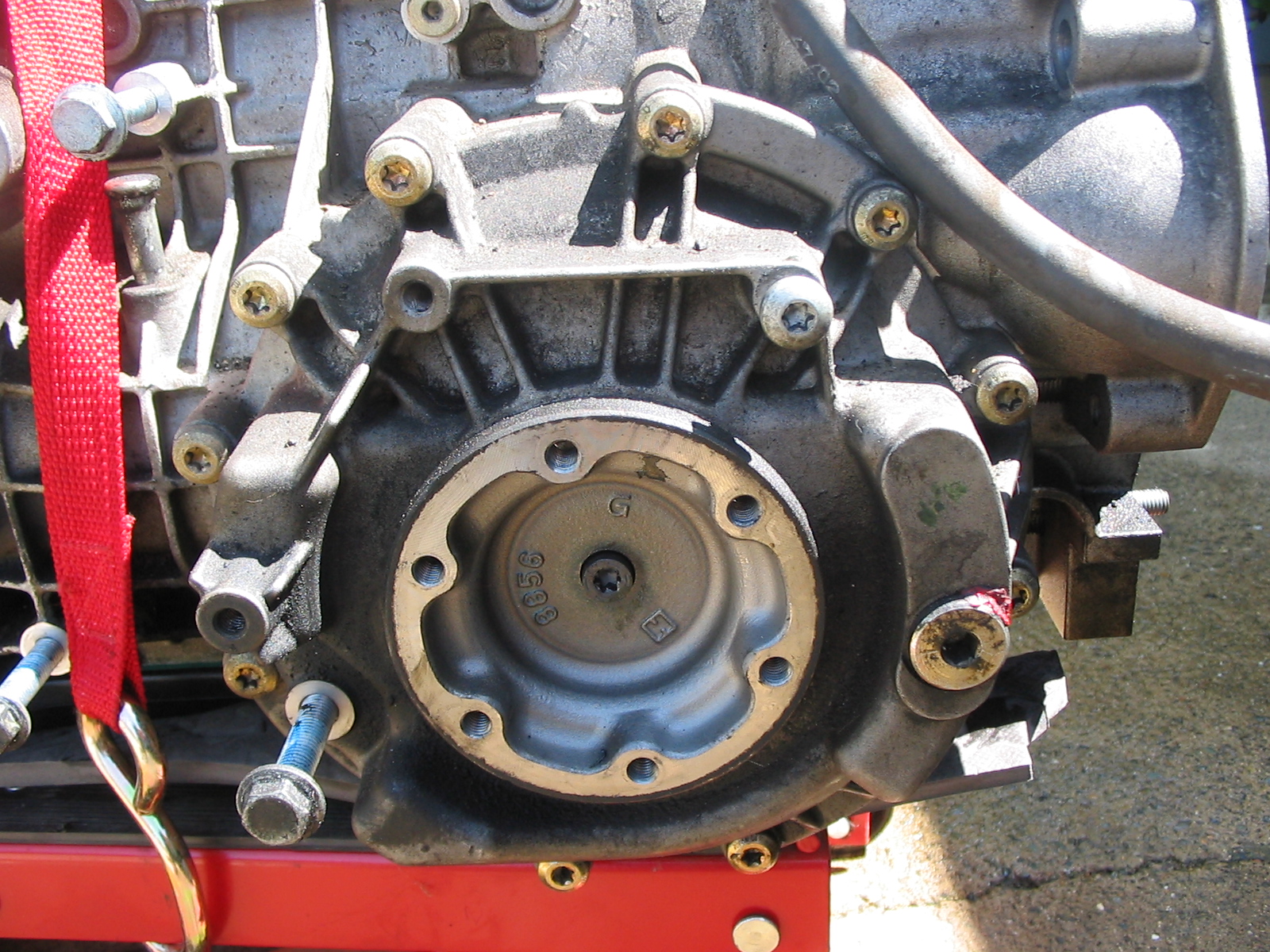

after separating the drive shaft from the differential and also separating
the left side drive shaft from transmission, you will be able to see the center
bolts, again you don't have to remove the center at all to remove the differential

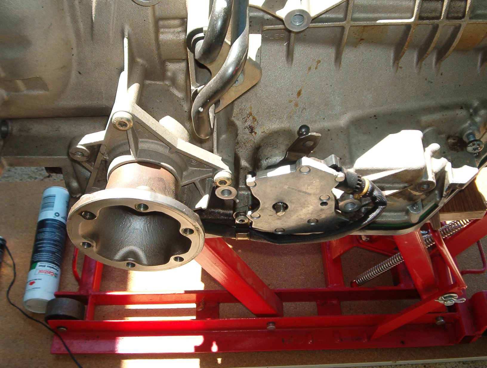

take a look at the pix below
be prepared to have a pan under the differential to capture the diff. fluid
note that you have to take the left side first because its is attached to the diff. as you know
for the left side have a pan handy to capture transmission fluid.
post-20238-0-62403000-1312952254_thumb.j
to take the left shaft out , all you have to do is remove the 3 bolts behind the flange and pull gently.
post-20238-0-46421900-1312953169_thumb.j
hope this will help you
