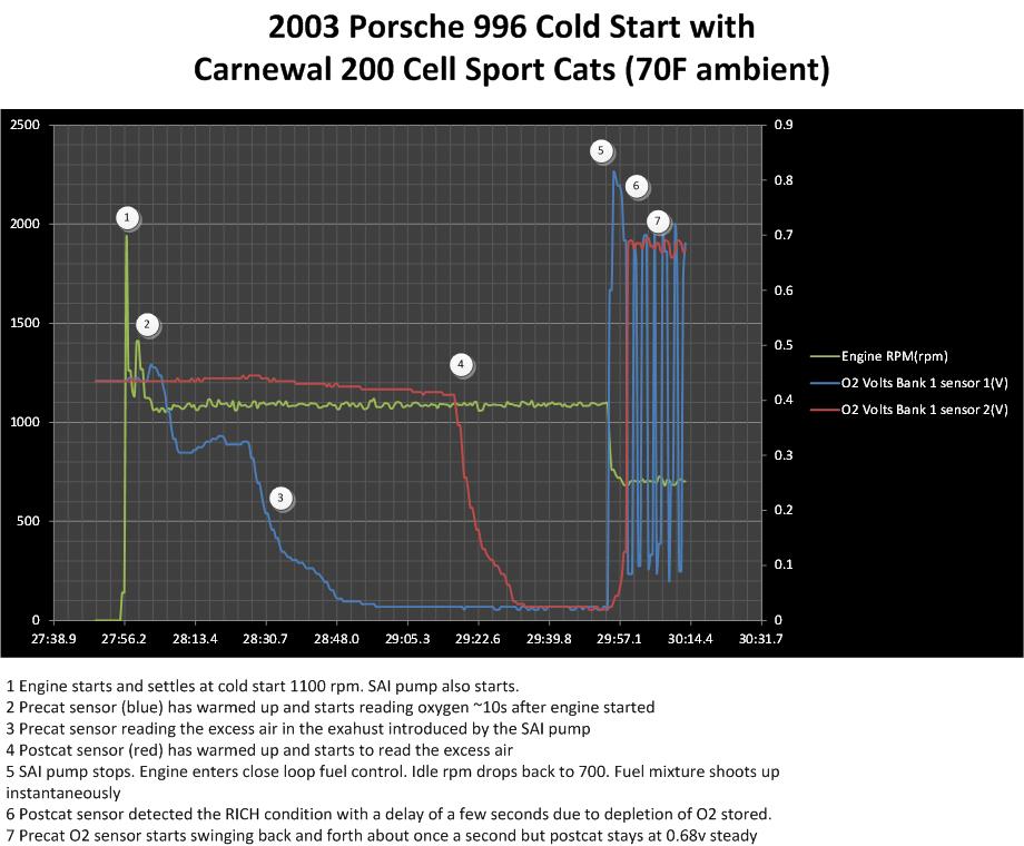

Do you have any scan tools that could read real-time O2 sensor reading? If you do, you can confirm fresh air is truly injected into the exhaust by the sensor reading. If you don't see actual air, that means the SAI air valve(s) are not working correctly. This was taken from my car (non-Turbo '03 C2) but you get the idea.
post-5282-0-15845000-1417630115_thumb.jp
Actually Turbos have A/F pre-cat sensors so you need to read the lambda values (instead of voltage). When extra O2 is present, the lambda should be greater than 1.0
