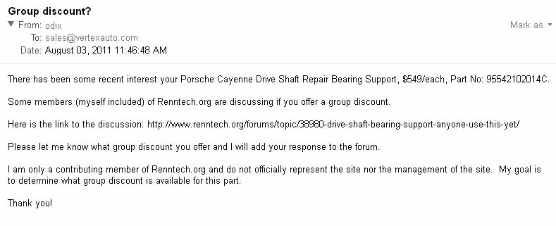

I asked:
Ah see they cut the old mount for removal. Clever solution - now how about we look into a group buy? :)
post-41432-0-01371600-1312397633_thumb.j
Well, I went ahead and ordered one. Was told there were only 2 left from their initial batch.
