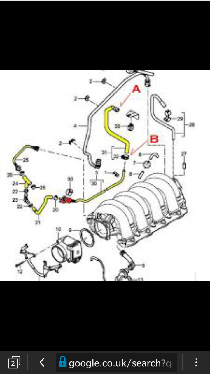

Unlikely fuel will create a single cylinder misfire so first thing is to switch ignition coil from 7 with 6 and see if the fault moves? If not put it back and move the spark plug instead. Rough running at all rpm is more likely ignition related.
The fuel tank purge valve is renowned for causing problems with start up after refuelling but usually comes with a 0441 code, also possible is evap canister clogged saturated or something.
Purge valve is in red on attached diagram. Pelican Parts has a good DIY. I changed mine already, pretty straight forward job, but I had the code to confirm the problem.
