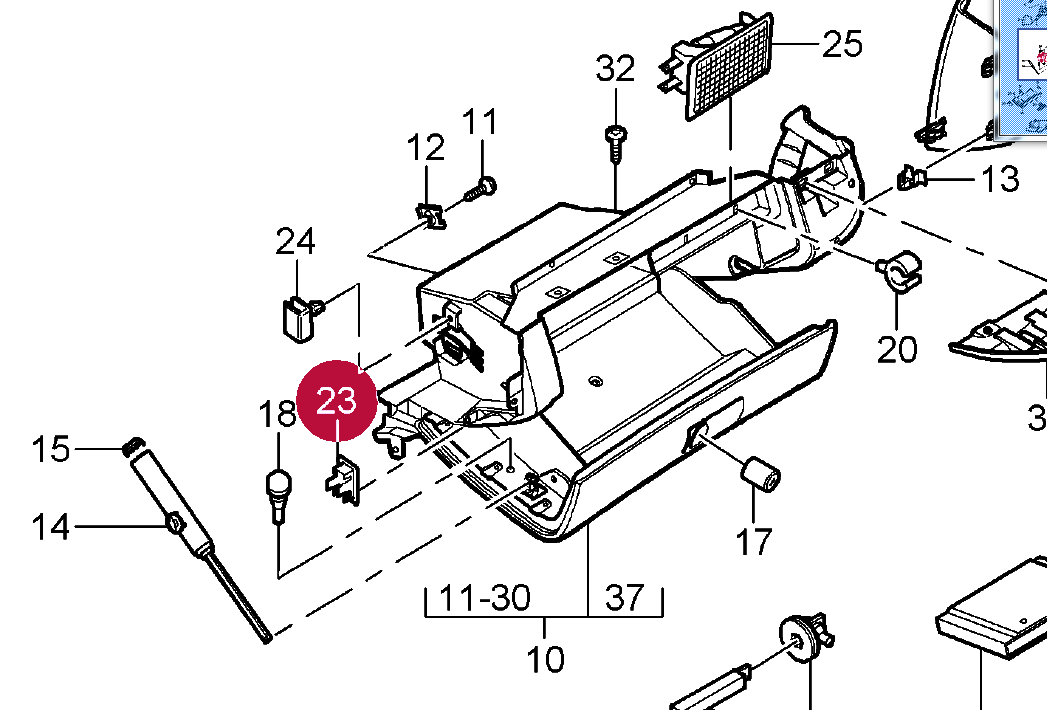

The microswitch is held in place by this holder (item 23).
thanks! it looks like i have to remove the the glove box to get to that? is there a part number or anyway to test it once i get to it?
