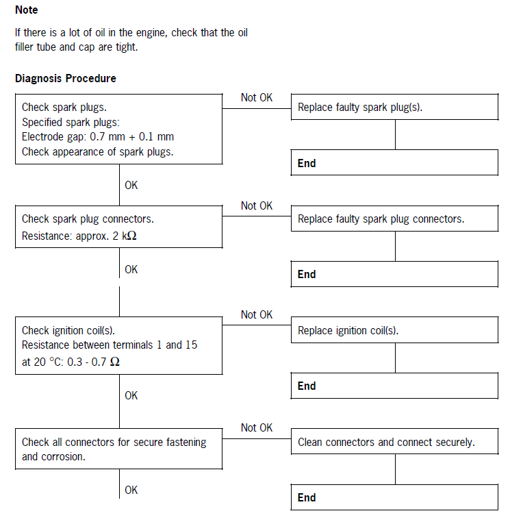

Thanks Loren for the 'trouble-shooting' chart.

Has anyone actually tested the resistance on a set of new coils?  I just got a set of new Beru coils, and the resistance between pins 1 & 15 on all 6 of them is right at 1.0ohm.  The chart above indicates that it should be 0.3-0.7ohms.
Should I be concerned?
Absolutely not. Most inexpensive meters have a lot of error getting close to Zero. If you use 10 different meters you will get 10 different readings. When the coils fail the resistance goes very high all the way to completely open.
just connect the meter leads together and lets say for arguments sake they read 0.3 Ohms, deduct that from your reading and you've got the actual reading. (or at least as accurate as you are getting with that meter) In reality accurate readings are done with 4 leads to sense inputs on the meter too (usually an accurate bench meter, not hand held) that removes the resistance of the actual leads.

After removing the old coil packs, I saw that they are, indeed, different part numbers.  The original (factory) coils for my 2008 Carrera S were Beru 0040100021 (Porsche 997.602.102.00).  The new ones were Beru 0040100036.  The old ones were a little less consistent.  They were 0.7-1.0 ohms, so still about the same resistance.
The new ones are installed, and so far things are looking good.  I was previously having some intermittent misfires (when the car was very hot from long drives or track days) and low MPG under normal driving.  It's hard to reproduce the misfire symptom, but I should be able to tell pretty quickly if my MPGs have improved.
