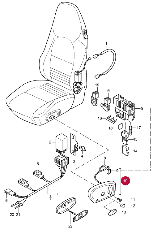

Hello, this is my first post on this site. I am a first time Porsche owner of a 2000 Boxster 2.7l with design package. I am seeking a part number and source for a small plastic component that attaches to the backrest adjustment lever on the driver's seat, interior side of seat. It is black in color. I appreciate any assistance!

The bad news is that Porsche does not sell those knobs separately. They only sell the whole switch assembly.
Your best bet is a salvage yard that has 1997-2004 Porsches.
If you are looking for the knob that is located about shoulder high - on either side of the seat back - that releases the seat back to tilt forward:
996.521.421.00....control button....left....MY99 -> MSRP..$2.90
996.531.422.00....control button....right....MY99 -> MSRP..$2.90

Thank you!!! Both of you were very helpful. A great first experience within the Porsche community. Thanks again and God Bless.
