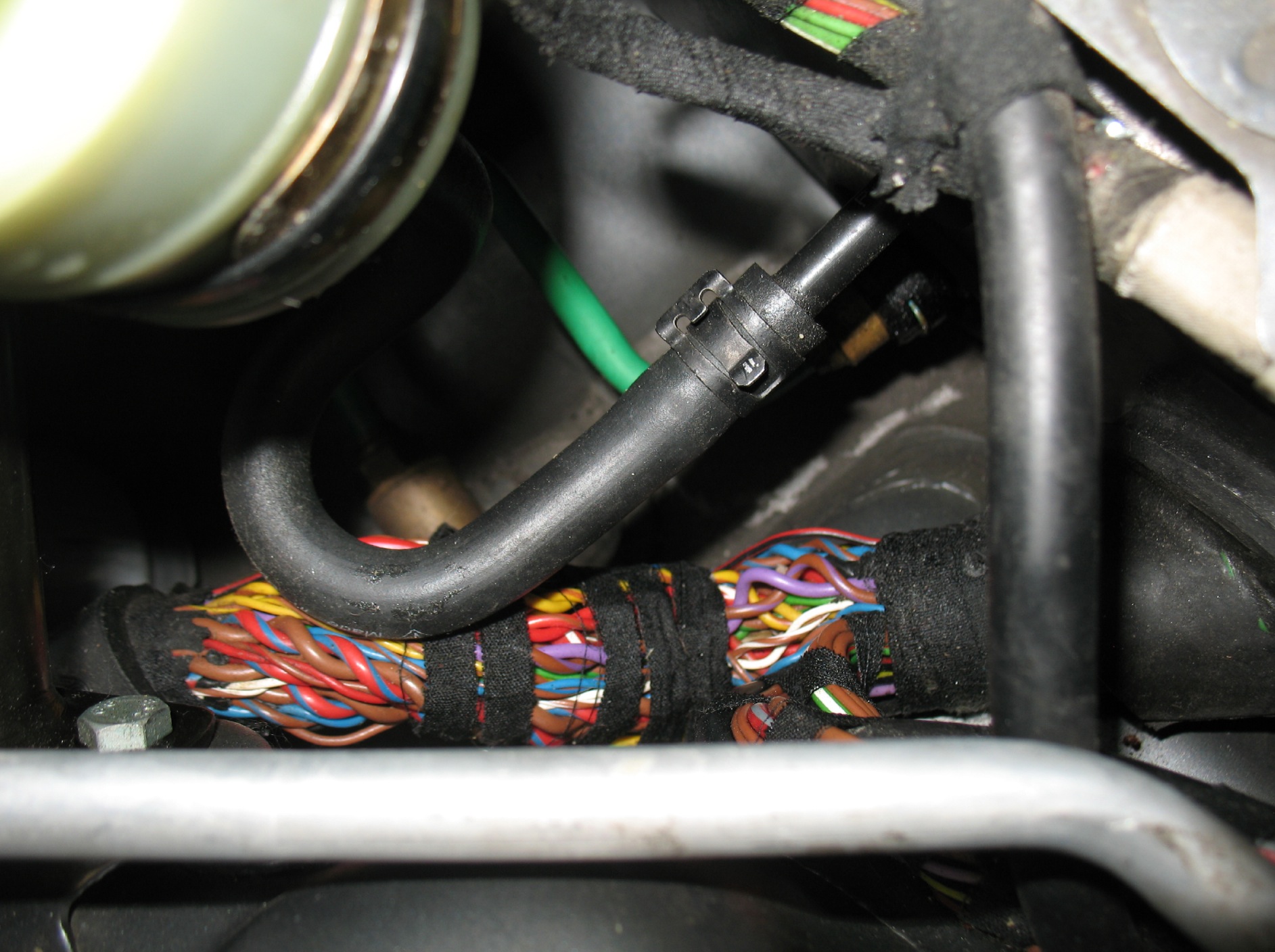

Are you talking about the clutch reservoir or brake fluid reservoir. There is a lot of wiring in both cases. Hope the mouse didn't heat anything in there....

JP, thank you for correcting me, I did mean to say the clutch res. Are you familiar with the grommet? I would guess that there normally isn't an oddly shaped hole in the bottom...? Looking at your picture of the clutch res, it is directly below the forward most fitting of the green line shown. Does that lead to the area that Loren was referring to? Is there a way in there from below? Also, how would I get to the area that Loren mentioned if it is different form the one below the grommet?
You've also brought up a good point about the wiring. it looks like there has been some foul play at the large wiring junction but I used a mirror and a bright light and I can't find any evidence that any of wire insulation was chewed through. Hopefully the only damage there was to the tape/wrap.

If, on the pic I just added, it is what you are asking for (see arrow), it is only a rubber plug with an opening "funnel type" that it used to serve as a drain if water or oil is accumulated in this compartment.... The other picture posted is to show you the maze of wires is normal.. The other place you should look at is under the fuel access cover. The black cover held with four nuts....

That is the grommet and I think the critter chewed the bottom of the funnel because the hole at the bottom does not look factory... From your statement it sounds like it does not lead anywhere an animal would get stuck and die.
That is the wire bundle. It looks like you might have separated the wires a bit. Did you do that to inspect them? I think that is what I should do to verify there aren't any shorts.

Pleasure to help a desperate TT owner ;-) Yes I did a bit of wire inspection after a clutch slave failure, that make the clutch reservoir overfilled, and the wire soaked with oil (Pentosin)....
